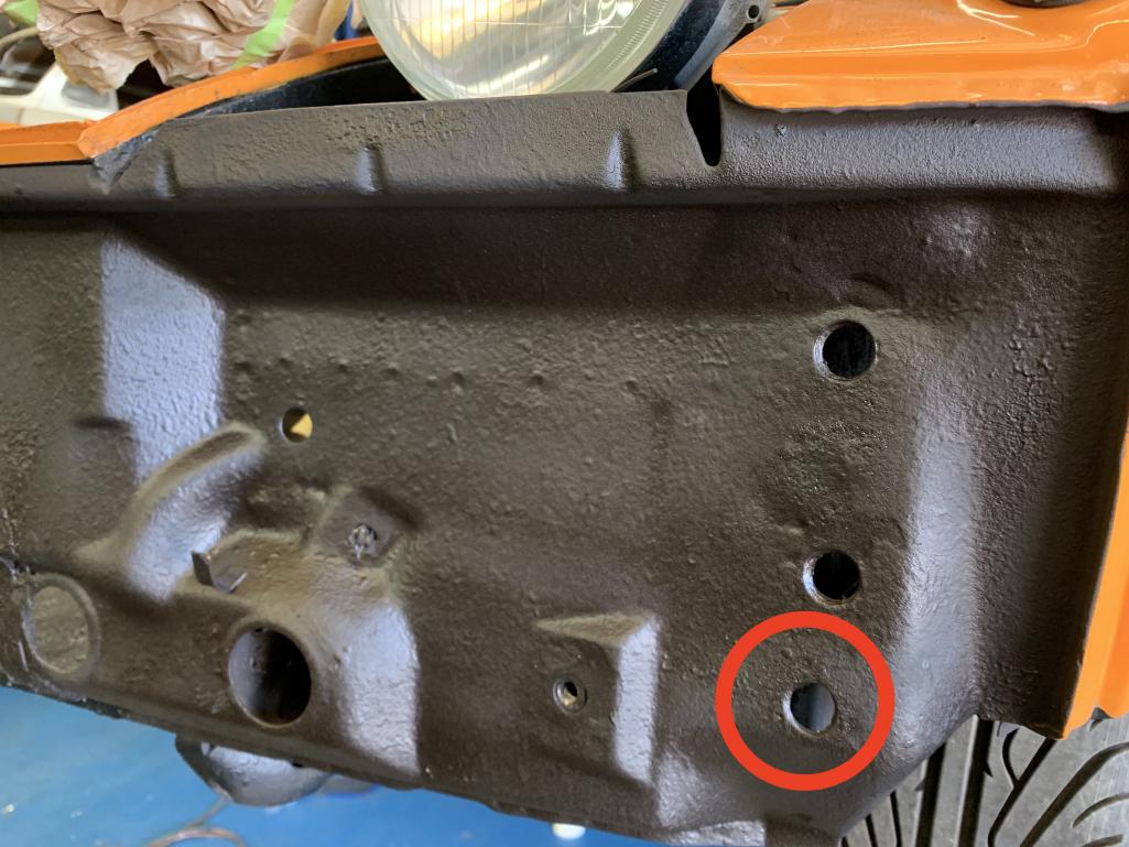

The units I started off with was pretty bad. You can see in my original post that we had to actually widen the front significantly, flair-out the ends, top off the edge meeting the wheel-wells, etc. All this before we actually started 'shaping'.
While some body work to the valances is expected when adding flairs (every car is, by nature, going to be slightly different) I found that the amount of work going into the pieces to be pretty ridiculous. For members that don't have a 'body-guy' and a 'fiberglass guy' on staff, this is going to be cost prohibitive when you consider a $60-$90 per hour rate.
I'm not sure how other manufactures produce and mount the unit, but the current design we are working on has the Front valance mounting to the body. Two M8 'studs' will insert below a new-hole drilled just below the holes to mount the from-bumper (jig/template will be provided with the piece).

There's you problem... you factory spoiler screw holes are covered in bedliner crap.
The inset rocker covers are factory. They bug me too but hey its 70s style. I think the flush fit you are going for will look good.
The factory chassis jigs weren't that good, then add hand fitting flares, you will never get perfect fit flared rockers to customers. It will only be 'good enough'.
