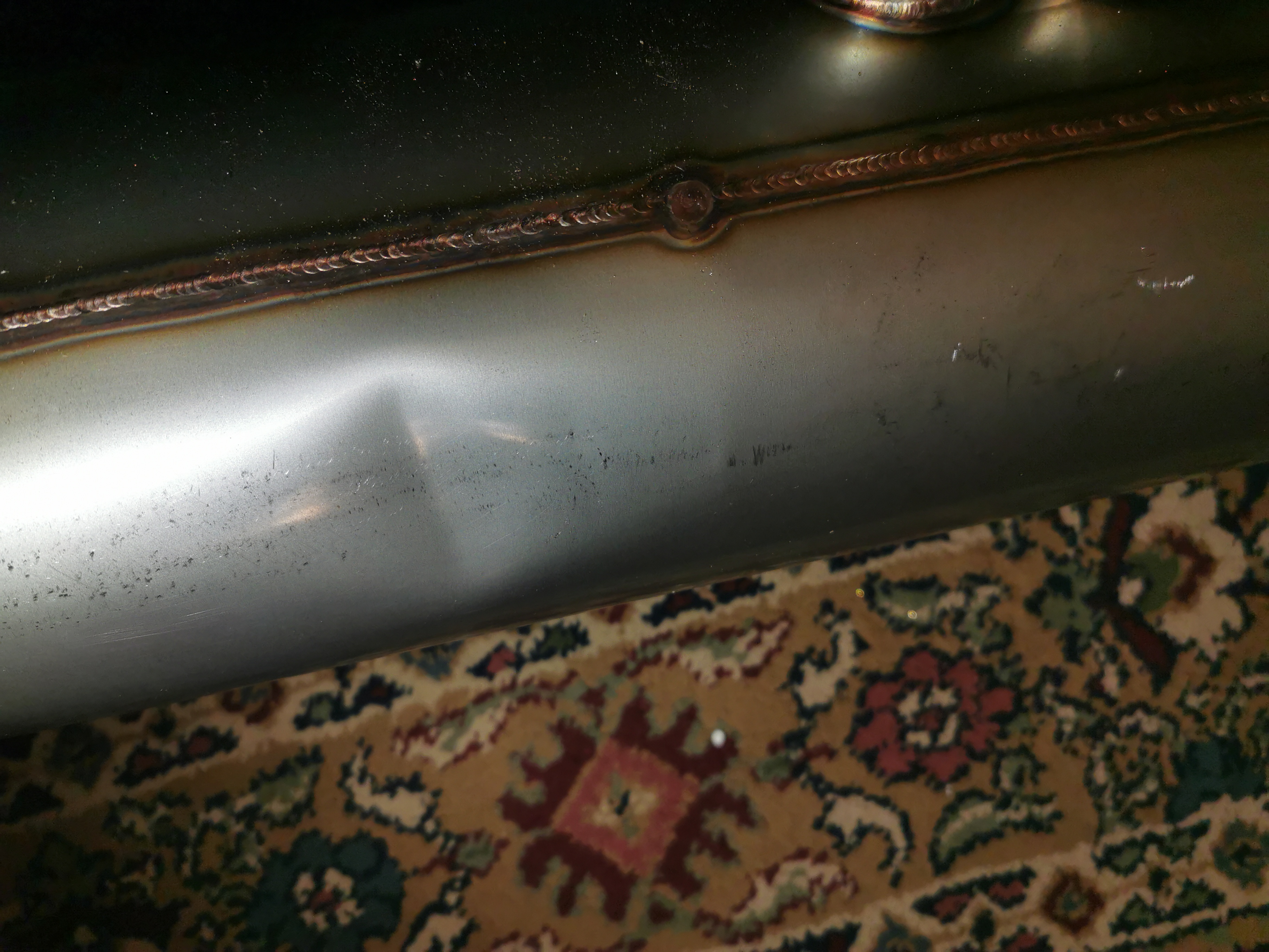

Hi All,
Received my muffler. As other reported, it is a work of art.
Unfortunately, mine was manhandled by the gorillas at UPS. There is a 2.5 inch dent in upper left, near the weld line.
Ben has offered to let me return it as well as some suggestions to remove the dent. On the one hand I know I am being a bit obsessive as it *probably* will not effect sound or performance and may not even be visible once on the car. Anyway, wondering what others think in terms of repair options, returning, living with it whatever.
Ben suggested blocking the inlets and forcing done compressed air via the tailpipe. I did try this to no avail. Have not come up with a great way to seal / fill the tailpipe so not sure if the actual psi. 2.5 us not a standard plumbing size. Given gauge if metal, not sure if air without heat is enough to pop it.
Ben also offered to send me a paintless dent repair kit he has. Again, not sure if that will work as they are generally made for thinner gauge body panels and / or the hot glue might not stic to the stainless. I did try with just a heated glue stick but it popped right off.
Another option could be to use electric stud welder to tack a stud and pull the dent. However, do not want to turn one problem into a bigger problem.
Yes, we could do a UPS claim but, from my experience, UPS always blames the packaging. There was no visible damage to box. Likely it was dropped in an edge like lip of truck.
As noted, I could just live with it. Open to other ideas.
Thanks.
