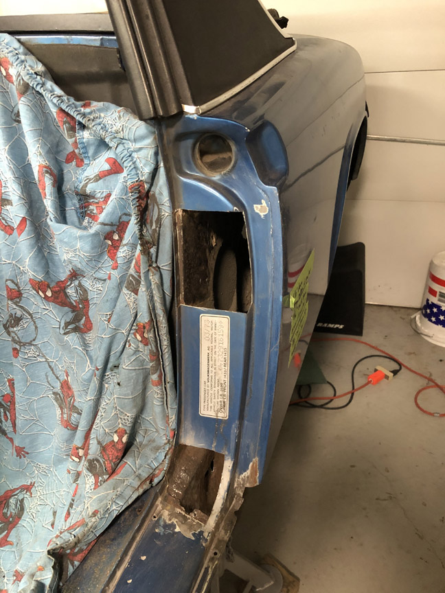

I was able to spend more time today on the car, stripping off rusty metal. I got the jackpoint pyramid and tube off. And cut out most of the rust at the bottom of the latch panel; not sure how much more I'll be taking off, but at least a little more.
I also cut out the section where the door latch mounts. I was really hoping to leave that section of the latch panel intact and just fill the little rust holes. Unfortunately, I couldn't get the support piece behind it out without better access; so, out it all came....

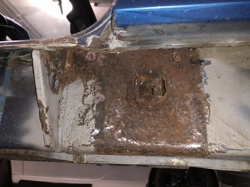

Also, here's what the recessed pyramid area inside the jackpoint looks like:
This side is definitely worse than the other side. So, I'm going to make a replacement piece out of some 16ga galvaneal I already have and weld it in. I've left the part in place for now, so I can make a pattern off of it (more masking tape...). It's fairly complex, with four triangular panels and a recessed pocket at the bottom for the jack tube, so it'll end up being two pieces welded together.
