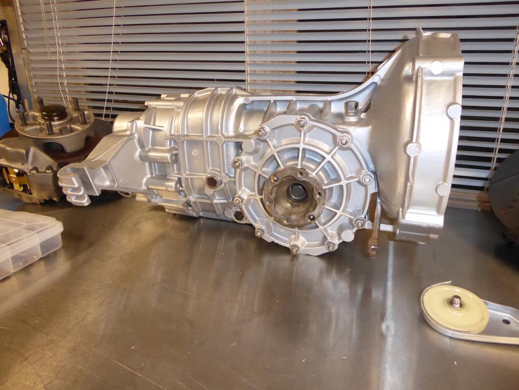

I just cleaned mine really good and painted.....If it come's off I'll touch up. Not a perfect solution but a stop-gap. MarkAttached Image
