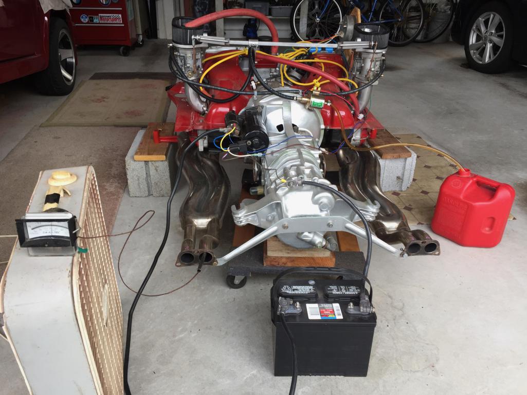

I cleaned & cleaned again and again, then painted using Zink Phosphate primer & Tempo engine enamel #207 It's holding up well !
