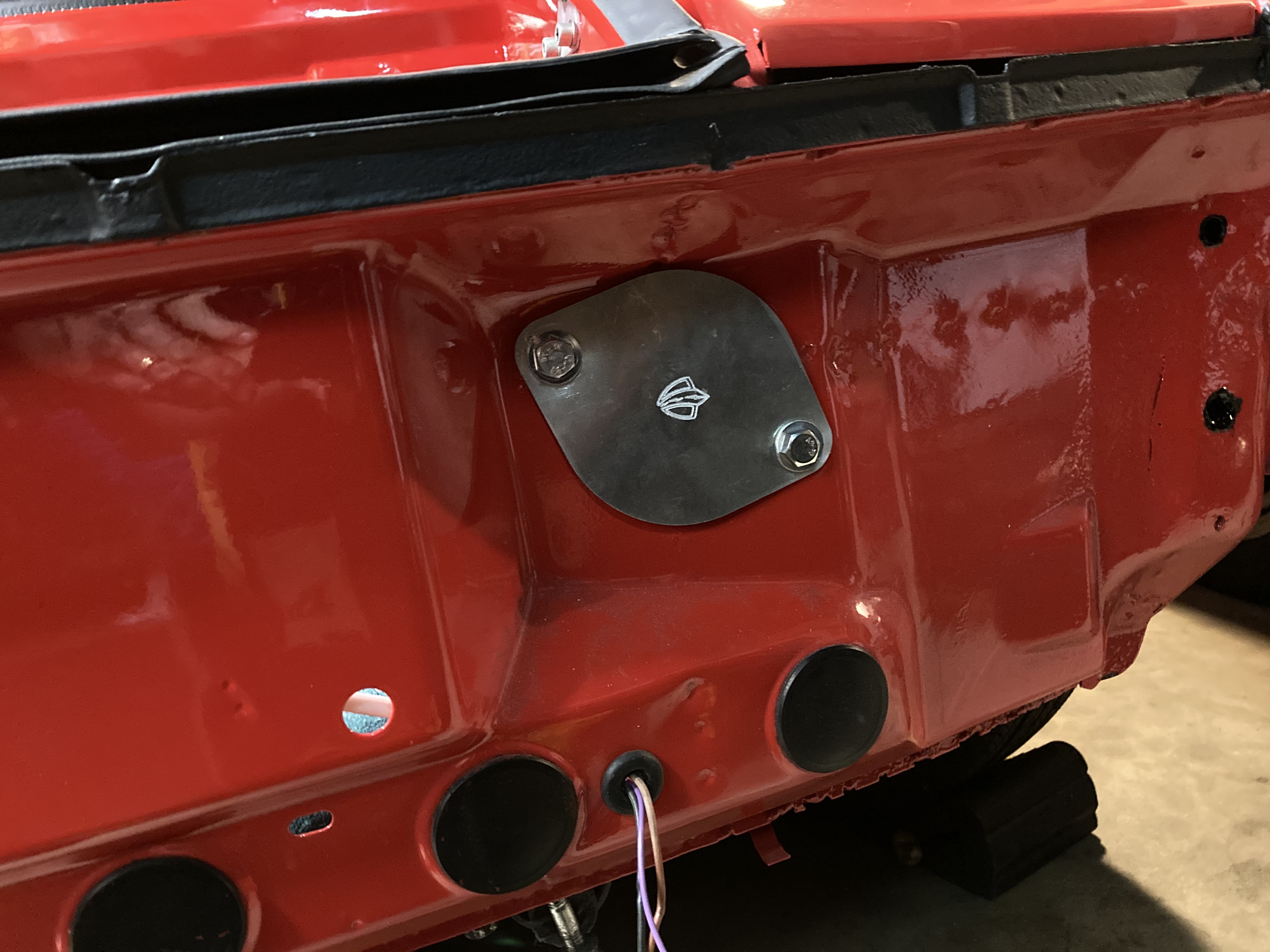

I think installed the above sheet metal plates to seal up the big holes in the front panel. Some folks weld in patches here, but I chose to just leave them as I am better at cutting sheet metal and bolting it in than I am at welding.
A perfect fit for those shock holes is an item sold by EV West, used as a cover plate for the hole remaining in the bell housing after removing the starter from a VW/Porsche. Link here:
https://www.evwest.com/catalog/product_info...dug81o4j2u54ii2
