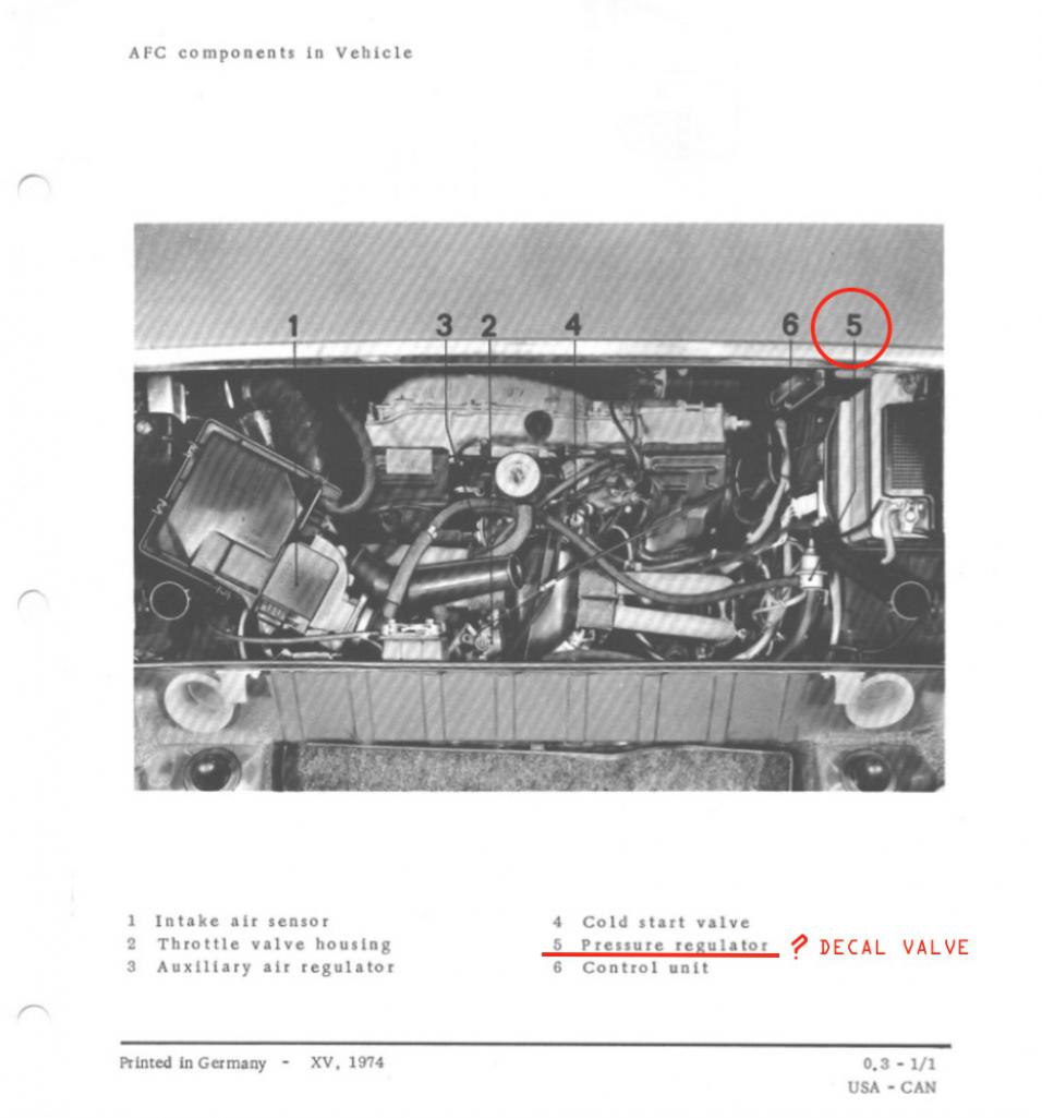

an error in the factory manual.
this notated image in the factory manual identifies #5 as a pressure regulator. it should be the decal (de-accelleration) valve. the pressure regulator, or by its full name, the fuel pressure regulator looks similar to the decal valve but is on the lhs of the engine under the air cleaner. |
