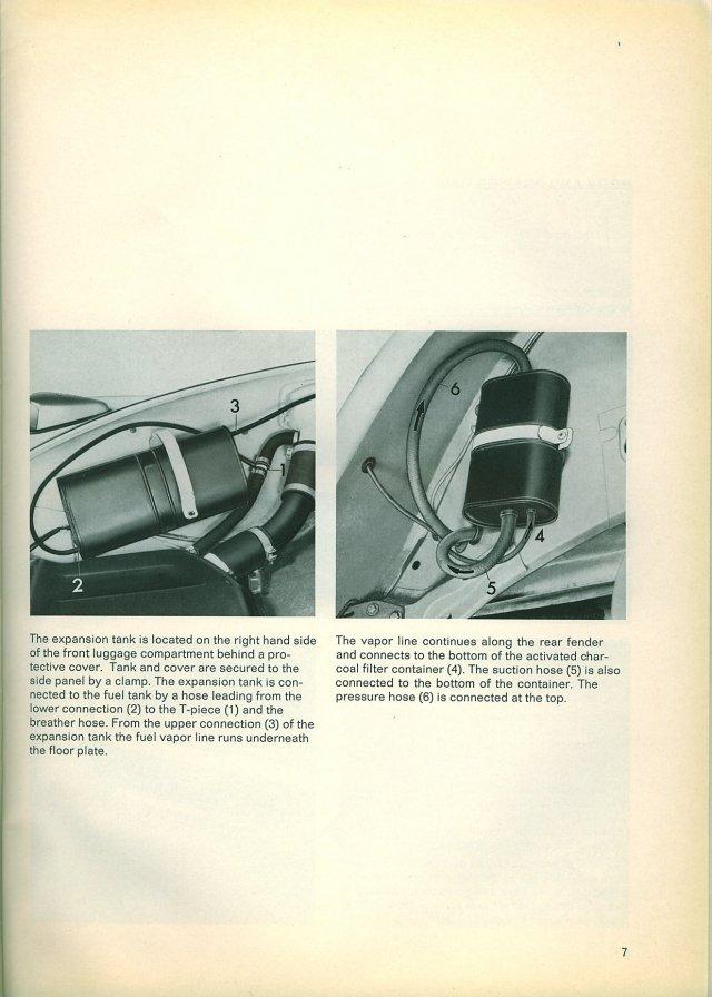

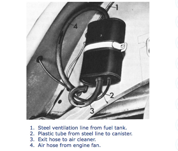

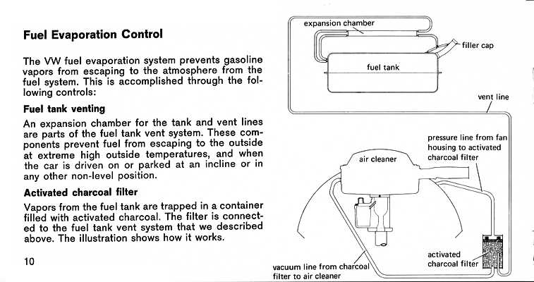

of interest re evap emissions plumbing.
73 beetle.
cannister is tucked up under the back guard in beetles.
bottom of tank.
fuel tank vapor line
suction line to bottom of cartridge.
pressure line to top of cartridge.
fan provides pressure.
throttle via aircleaner provides suction.
same system, parts and principle as 914?
