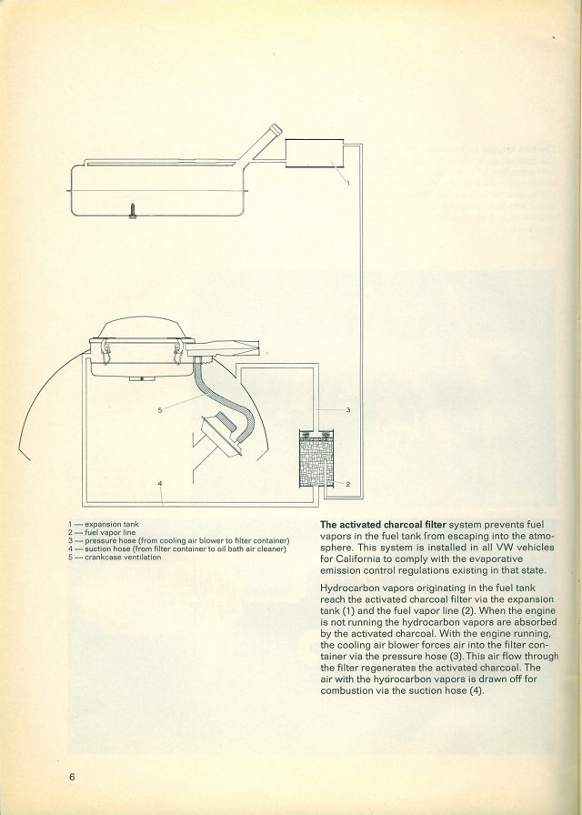

vw technical booklet, date 1970.
explains the evap system.

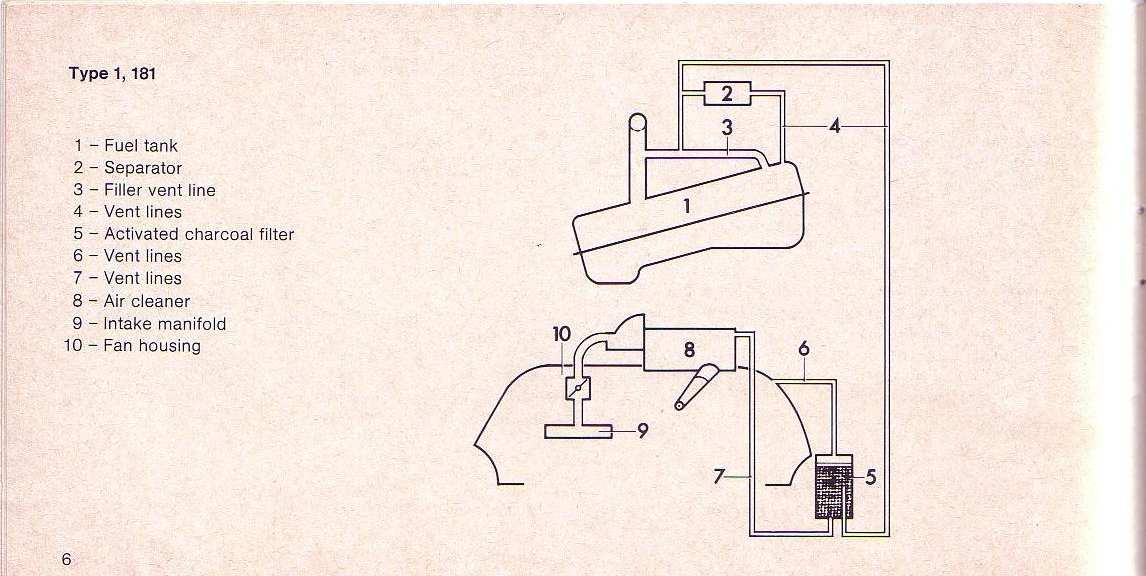

1975 VW emissions warranty type 1,2 5 years later. same.
the 1973 emission warranty diagrams are the same as for 75 and same as tech booklet 1970,

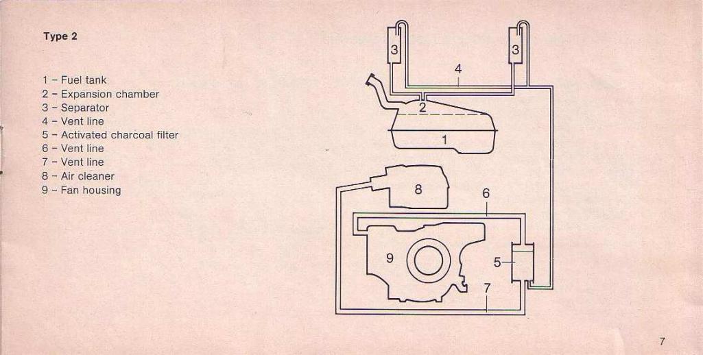

technical page for the kombi (bus) evap system.
(note when looking at this the fuel vapor line is on the far side of the cannister and not visible, but its paired with the air cleaner line).
diagram for the type 2 kombi (bus) for 77 to 79.
type 4 engine.
they are all consistent with plumbing arrangements etc for nearly a decade.
they agree with the arrangement in the 74 914 1,8.
