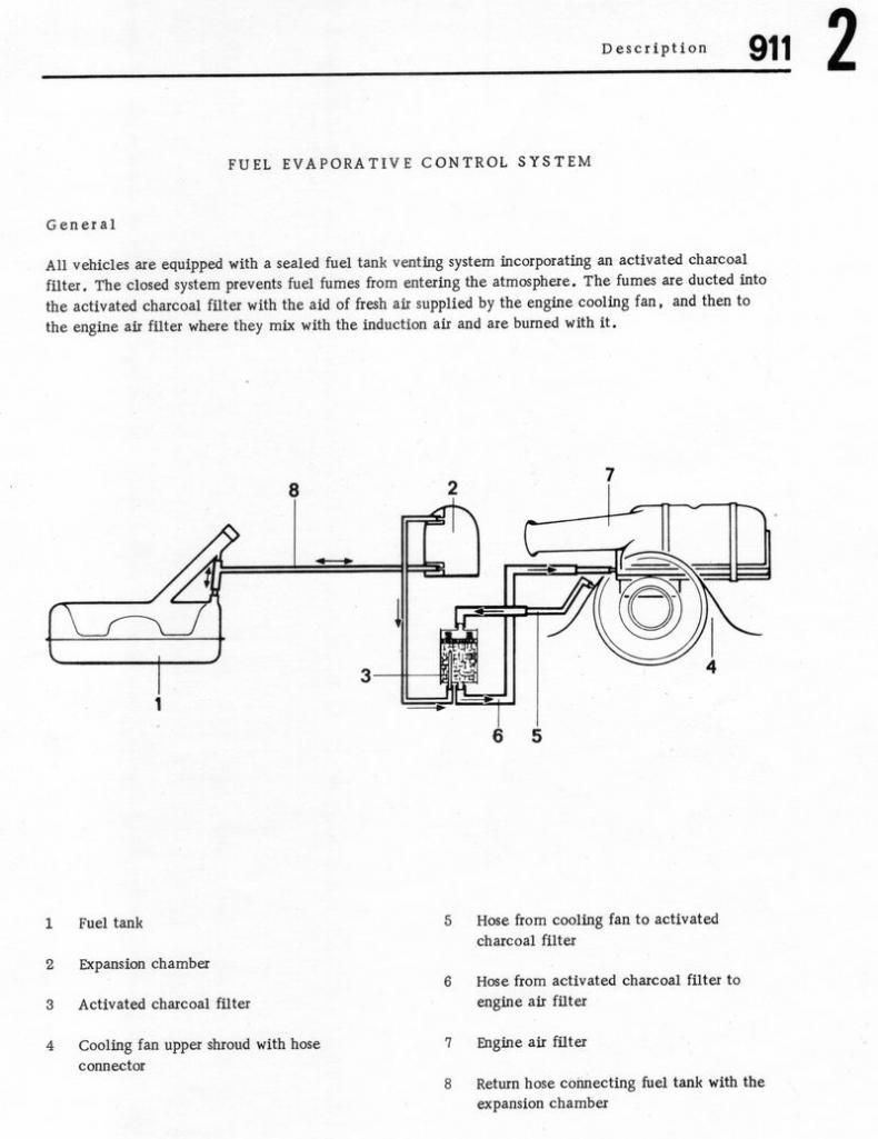

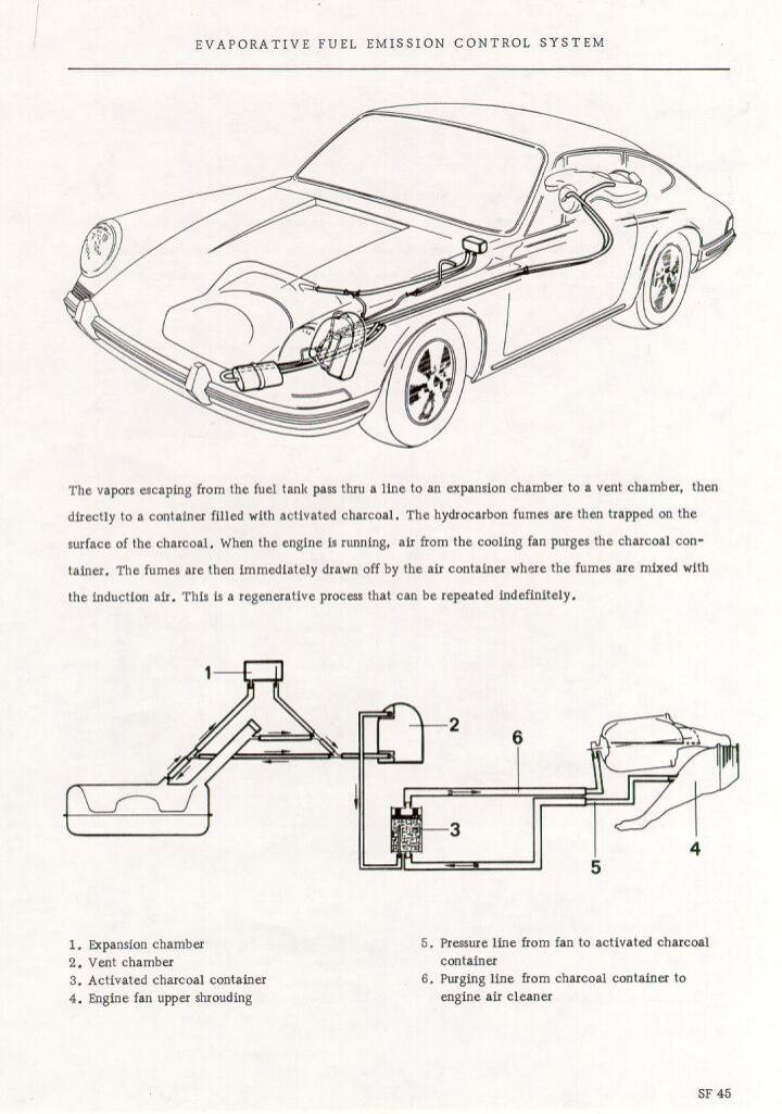

but this one is interesting.
porsche evap emission system for the 911.
1970
1974
The 1970 911 porsche system agrees with mr. b's firm view that the 914 cannister is plumbed up opposite to the plumbing we find in our 74 914 1.8.
The 1973 911 porsche system has been altered from its earlier 1970 design, now plumbed the opposite way and is in accord with the plumbing in the 74 porsche 914 1,8.
I have no reason to doubt mr. b, i have never seen earlier cars in detail to know, but the schematics for the 911 support the idea that there was an earlier system and a later system.
