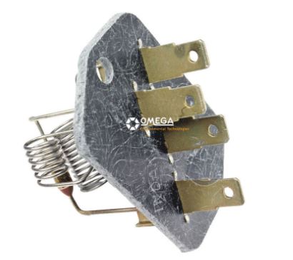

Not trying to be a kill joy on the DigiKey resistors but I suspect that in the desire to find a nice "modern" looking resistor you've over looking the physics and the cooling requirements.
These packaged high watt resistors require a heat sink to last. Once that aluminum case gets hot and has no heat sink to pull the heat away, it will get too hot and burn open in short order. That's why I referenced the idea of wires exiting the HVAC case and having to mount it on the sheetmetal body as a heat sink.
Likewise, that style of heavy resistor if left unsupported within the blower case is going to fatigue the OEM resistor standoffs that were not designed to support that kind of resistor weight when dynamic road loads are imposed on it.
A thick gauge wire wound resistor in open air is going to be able to handle more current and heat rejection than a nice neat ceramic or aluminum heat sink package that looks aerospace cool.
I look at it as the industry having converged upon the best, most cost effective solution and it's not one of those DigiKey style resistors.
Poke around on internet and you'll quickly find the converged solutions are resident in the blower case, they are air cooled. Typically open wire coil, large ceramic, or Solid State with big honking cooling fins in the air stream. You'll notice in a couple that the bi-metallic thermal cut out switch has been replaced by a more modern component though!

Wasn't trying to find a modern looking resistor. I was just trying to find any suitable replacement. I was actually searching for open coil resistors like what are in the blower and shocked not to be able to find them among the 500,000+ resistors in their catalog (or anywhere). I'm not saying they are not there, only that I couldn't find them.
I am a bit offended though. (IMG:style_emoticons/default/happy11.gif) Even I'm not dumb enough to try to hang one of those chassis mount resistors from the OEM standoffs. I envisioned mounting to an aluminum plate, glued to the base of the resistor pack, and connected with flexible leads. Irrelevant if they are not suitable.
I'm still puzzled why open wire coil resistors are not easier to find. Even resistor wire is kind of hard to find. All the stuff I've seen is annealed and too soft to make those spring like coils.

DRPHIL914   this is how the wiring should be connected. i am ...   Mar 26 2021, 08:35 AM
Mikey914   Doing some research. Looks like we can form these ...   Mar 26 2021, 02:42 PM
Bullethead   A huge thank you to all the contributors of this t...   May 11 2023, 06:46 AM
