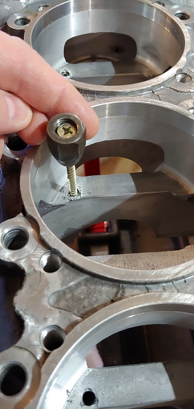

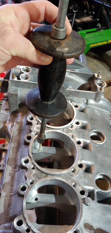

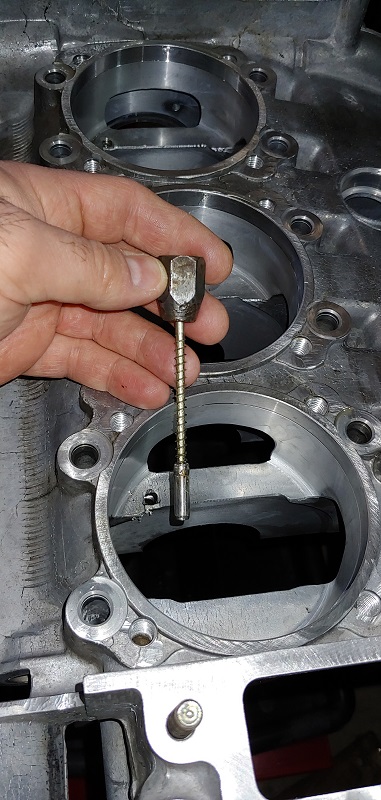

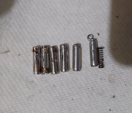

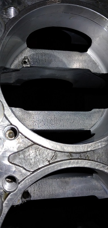

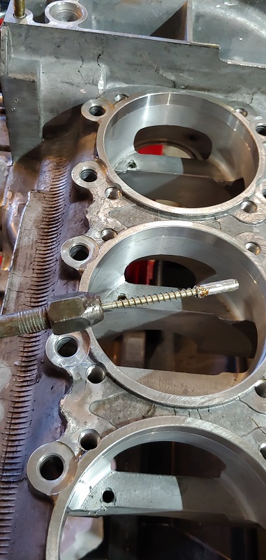

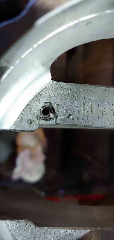

Luke M   Getting the case ready to assemble. I have all the...   Oct 24 2020, 01:45 PM
altitude411   Anyone know why Porsche went with the oval lock...   Oct 24 2020, 03:35 PM
