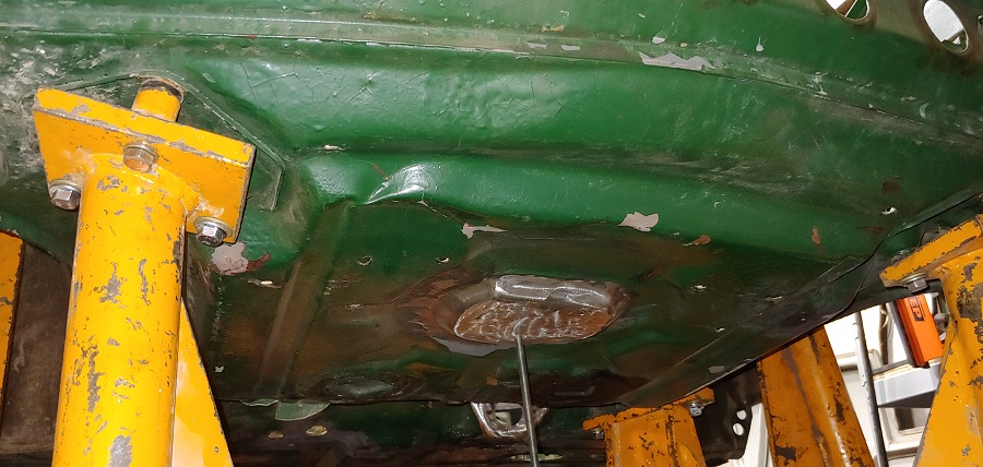

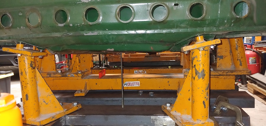

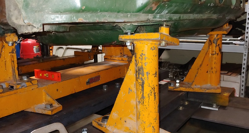

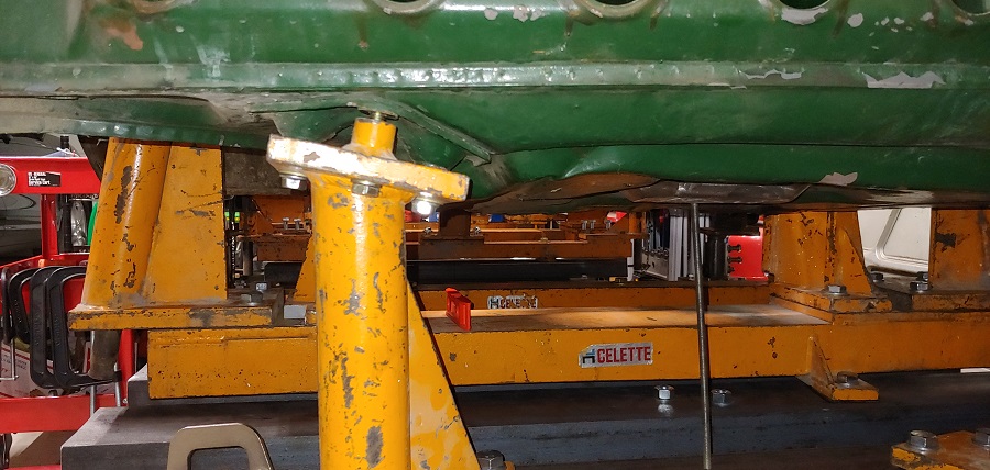

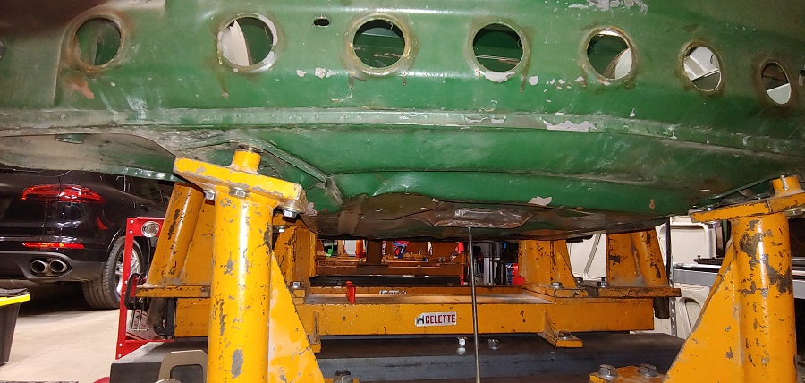

Right A-arm mount issue to be addressed. 5-8 mm upward hit. You can see where it took the hit on the front trunk pan. I need to cut away some of the pan for the cooler install but I'll wait a little to do that. Time to straighten the mount first.

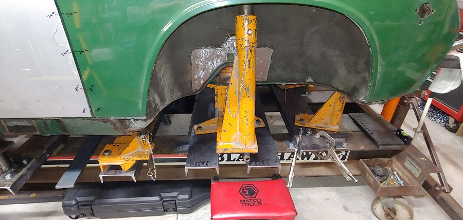

Luke M   The chassis is now locked down on the fixtures and...   Jan 27 2021, 08:10 PM
