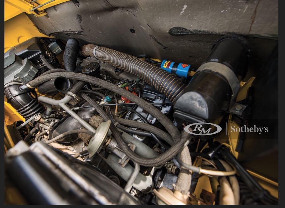

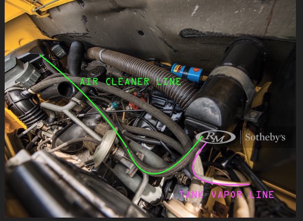

a reasonably reputable 75 1.8 example.
would say 99.9% trustworthy?
but you never know. the extra hose to the rhs heater outlet from the heater fan is a bit of a question mark. as far as i know its one hose only to lhs. so its had a mod?
and the long hose isn't a factory hose. nor is the coil original.
https://rmsothebys.com/en/auctions/mo17/mon...e-914-18/430426
same plumbing as SB and W cars, though can is in final position next to battery.
something changes in the 74 model year.
not saying it changed on the 2.0 L cars, i just don't know how they plumb up in the engine bay to the can. don't have one - don't have an opinion on those.
