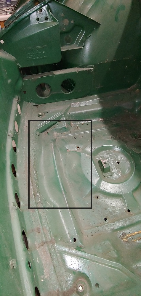

Well it's gotten to be that time finally. I've been collecting parts to do the repair on my 914-6 and now the work starts. The main issue is the hell hole/inner engine long, inner pass long, pass inner rocker panels are rusted out. The last part I was trying to source seams to be NLA. I sourced most of the parts from the good guys at Restoration Design. I received my order today for the last batch of things. Based on a few threads that I've looked over the outer shell to the inner engine long is currently not being made by RD. A few guys have made their own which looks like a real pain in the rear to do. I laid out all the new metal to see how things lined up. By the looks of things it will need some fine tuning to mate things properly. Before I start cutting into the chassis I'll build a few braces to keep things true.
Time for the pics...
Attached Image Attached Image Attached Image Attached Image Attached Image Attached Image Attached Image Attached Image Attached Image Attached Image Attached Image Attached Image Attached Image Attached Image Attached Image Attached Image

Front end fixtures are done. I need to rework the mounting plates on the rear before welding those up. I also need to go buy a hydraulic pull style ram to fix the issue at the front A-arm mount. (IMG:style_emoticons/default/smash.gif)

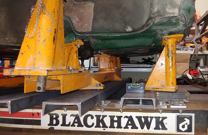

Luke M   Finally got the bench under the 6. This weekend we...   Nov 21 2019, 07:58 AM

Luke M   Got all the fixtures attached between the chassis ...   Dec 5 2019, 12:43 PM

Luke M   Work on mating fixtures to bench..   Jan 23 2021, 08:30 AM

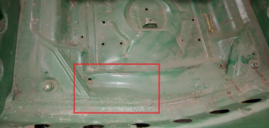

Luke M   Right A-arm mount issue to be addressed. 5-8 mm up...   Jan 23 2021, 08:38 AM

Luke M   Front end fixtures are done. I need to rework the ...   Jan 24 2021, 06:56 AM
