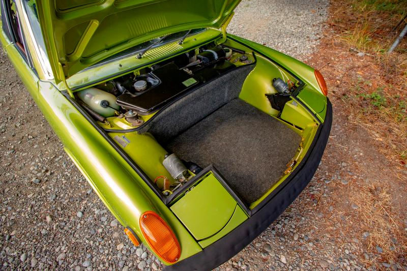

Another hose layout - presumably (?) a 74 1.8L with the charcoal cannister in the front; from a current posting on the PCA Mart.
Presuming the bumpers have been back-dated; the rest of the car (engine layout, interior) look like a 74. Maybe (???) VERY, VERY early 74??.
(IMG:style_emoticons/default/blink.gif)
