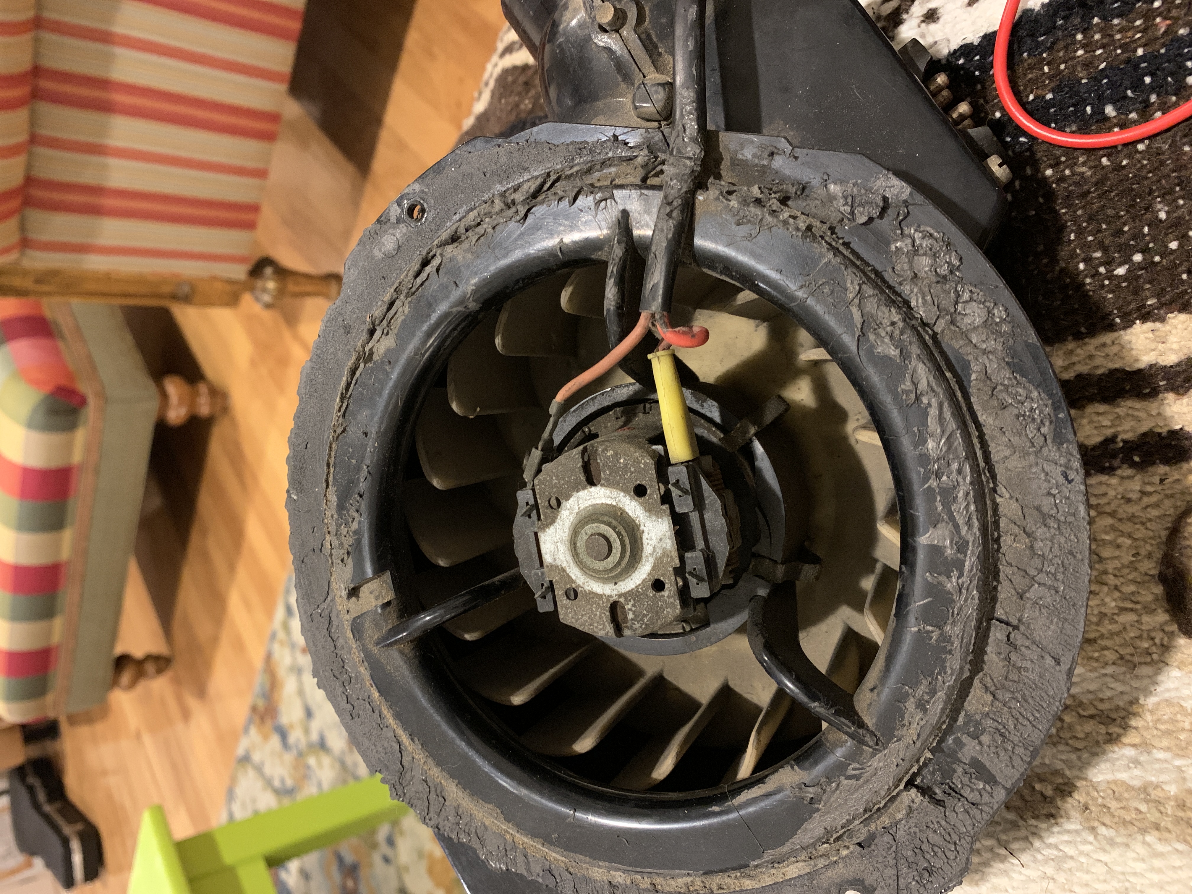

I have been dealing with this for 12 years, a non-running defrost fan. i even pulled this out 2 years ago and rebuilt it with new flapper seals and main body seal then made sure fan turned but didnt bench test the motor or resisitors, so as a result it still does not work properly. i will be documenting this because 914rubber and Mark will soon be putting together a kit for this that includes all the hardware seals and even a motor i believe, BUT i still have problems and questions!!! so i am starting this thread to get information on diagnosing the common causes of it not working and how to fix it, and then document the rebuild and replacement of the motor, fan, resistor and maybe the control unit in dash. Others have documented the reinstallation of the fan and the cables so i will not duplicate that. and we may want to link other threads hear that have done that as well.
Mark is sending me a kit soon, so while i wait for it, i will have to get some more information about the wiring and resistors function and how to test them .
I had this out last week and tested 3 different control units due to thinking that my issue was a control issue, because it runs on one speed, #2, and anything else does not work and it will then throw the fuse. most assume this would be caused by bad slider unit but i tested 3 of them and 2 are like new with no wear on the sliders , still same result. so i am suspecting the resistors /plug aparatus .
If anyone has done this and cares to share how to examine and test that for proper function, lets start there.
Resistor function, which lead is which and examination of the control units
I will take pictures of mine tonight and post those soon. once this figured out and fixed i will do a full step bystep on reassembly too.
Looking for lots of help and input on this, thanks!!!

Well it turns out I will be posting a WTB.
My blower works on all three speeds but the plastic housing is pretty rough. Cracked, missing clips that hold the 1/2's together, and one set of clip mounts is broken off completely. Motor vibrates like bearings/bushings are worn and/or needs to be rebalanced.
Not sure who messed with my car somewhere in it's life but it was certainly owned at some point by the type of person that you could lock in an empty room, alone with two ball bearings. Come back 1 hour later and they would have broken one and lost the other. (IMG:style_emoticons/default/av-943.gif)
OK, here are my measurements. Hope this helps you troubleshoot yours. @DRPHIL914
All were measured at 70F so amperage could be sustantially higher on cold morning with a sluggish motor that is drawing current closer to stall current. I'm surprised at the current this little bugger of a motor can draw! No wonder it's on a 25A fuse!

thanks foe the info, just pulled my original fan and housing and just sitting here checking resistance of each circuit i get less than 1 ohm on each one , in fact all 3 test at about .8.
so i guess new resistor pack is necessary, but i will be pulling this apart, the fan does not turn easily, new bearing ans seals and maybe motor , will see if i can clean it all up once it’s out , doesn’t look too good, it’s been apart before someone put it back together and used silicone sealant between the upper and lower parts ugh.
