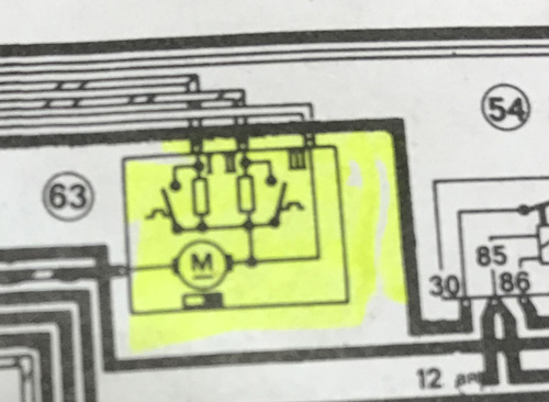

I have been dealing with this for 12 years, a non-running defrost fan. i even pulled this out 2 years ago and rebuilt it with new flapper seals and main body seal then made sure fan turned but didnt bench test the motor or resisitors, so as a result it still does not work properly. i will be documenting this because 914rubber and Mark will soon be putting together a kit for this that includes all the hardware seals and even a motor i believe, BUT i still have problems and questions!!! so i am starting this thread to get information on diagnosing the common causes of it not working and how to fix it, and then document the rebuild and replacement of the motor, fan, resistor and maybe the control unit in dash. Others have documented the reinstallation of the fan and the cables so i will not duplicate that. and we may want to link other threads hear that have done that as well.
Mark is sending me a kit soon, so while i wait for it, i will have to get some more information about the wiring and resistors function and how to test them .
I had this out last week and tested 3 different control units due to thinking that my issue was a control issue, because it runs on one speed, #2, and anything else does not work and it will then throw the fuse. most assume this would be caused by bad slider unit but i tested 3 of them and 2 are like new with no wear on the sliders , still same result. so i am suspecting the resistors /plug aparatus .
If anyone has done this and cares to share how to examine and test that for proper function, lets start there.
Resistor function, which lead is which and examination of the control units
I will take pictures of mine tonight and post those soon. once this figured out and fixed i will do a full step bystep on reassembly too.
Looking for lots of help and input on this, thanks!!!

" . . . so i guess new resistor pack is necessary". Not mentioning to beat you up but to reinforce how it important RULE #1 is in electrical trouble shooting. We've all done this. It was trained out of me and then has been proven by over 30 years of troubleshooting both electrical and mechanical systems.
Sounds to me first thing to do is to pull the resistor pack. Verify -- don't assume.
Resistors usually fail open. It is very rare for a resistor to fail as a short.
If you have 0.8 ohms on all three, it sounds to me like the bimetallic switches are continiously closed. Could be similar to Brent's situation. In his case, he had one of them closed all the time and tweaked it with a pair of pliers to be normally open as it should be. Testing with DMM can verify this.
However, if this is the case, you really should have 3 high speeds already.
You can bench test the fan with 12v battery and some wire jumpers. Did you try that by chance?
Lack of airflow could have overheated the resistors and caused the bi-metallic switches to become deformed and to have become normally closed instead of normally open per the schematic. That is a theory and an assumption. A bench test of the reistor pack and of the fan itself will verify or disprove that hypothesis.

DRPHIL914   ok update from trouble shooting last night, after...   Mar 25 2021, 06:52 AM
Rob-O   Quick question and I don’t have a schematic in f...   Mar 25 2021, 07:27 AM
DRPHIL914   Quick question and I don’t have a schematic in ...   Mar 25 2021, 10:22 AM
DRPHIL914   OK finally last night i was able to sort thru the ...   Mar 26 2021, 08:25 AM
DRPHIL914   this is how the wiring should be connected. i am ...   Mar 26 2021, 08:35 AM
