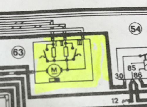

" . . . the resistance values seemed strange to me to, was trying to figure out how it would fail that way."
This is why a good schematic is a must have. Depending on the complexity of the system, It can be hard, if not impossible troubleshoot effectively without a schematic.
Good schematic from Haynes. B&W is a bit more work to read for color codes but all info is available. The schematic explains the switches, their normal position, and their operation.
Nice for color codes, but, a block diagram is useless for this type of troubleshooting. Explains nothing other than the colors of the wire.

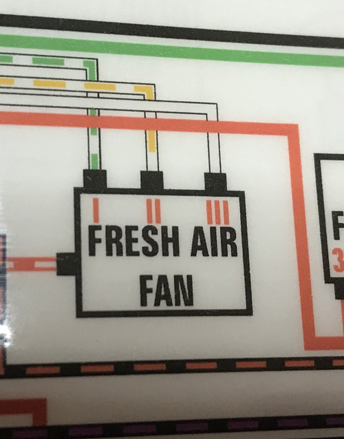

DRPHIL914   ok update from trouble shooting last night, after...   Mar 25 2021, 06:52 AM
Rob-O   Quick question and I don’t have a schematic in f...   Mar 25 2021, 07:27 AM
DRPHIL914   Quick question and I don’t have a schematic in ...   Mar 25 2021, 10:22 AM
DRPHIL914   OK finally last night i was able to sort thru the ...   Mar 26 2021, 08:25 AM
DRPHIL914   this is how the wiring should be connected. i am ...   Mar 26 2021, 08:35 AM
