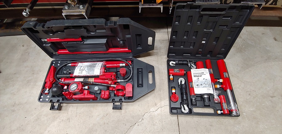

Got some new tools... I need to wrap up these rear fixtures and build some braces for the targa to windshield frame.
