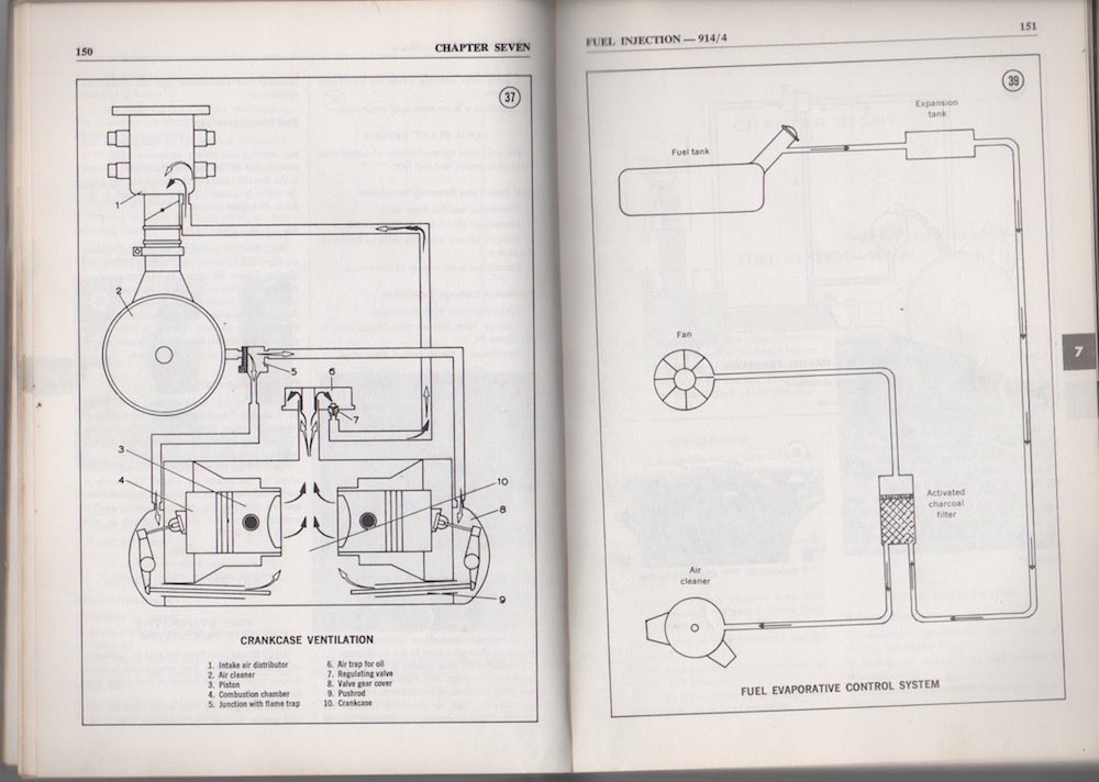

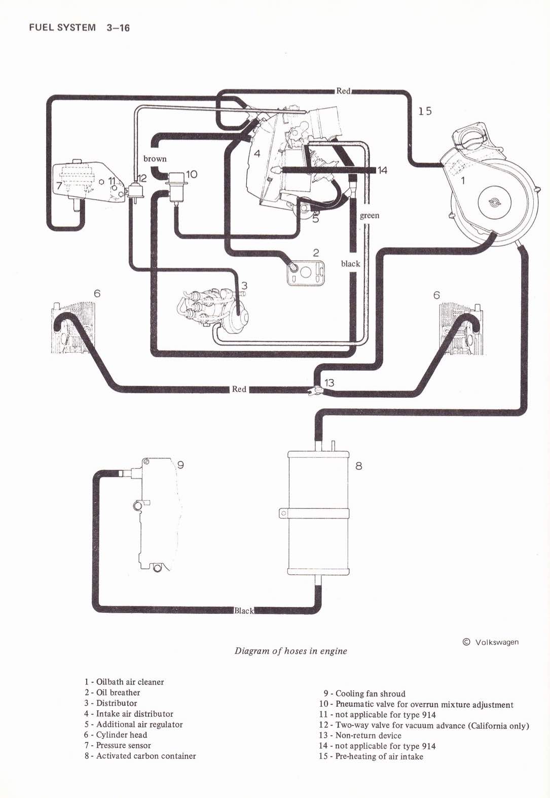

porsche plumbing of the evap system in the opposite manner would make sense to me then. vapor load from the massive carb setup would be significant enough to plumb the can so that the full length of the carbon contents could absorb vapors after shutdown before full saturation and vapor leaked out the fan hose at the opposite end located near or adjacent to the tank vapor line (with still some carbon separating those two).
i found other material in my files from independent publisher shop manuals that indicates vw plumbing for 914s. cypress manual 1986 and carbooks manual 1972.
probably means nothing. could also be a tech research error.
one way you could verify it with early cars since the lines disappear into the sills and emerge at either end in the front boot (trunk) and engine bay would be to pull them off and do a blow test to see which is which?
its easy to track the lines in a 74-on car - all fully visible in engine bay.
with early cars its a little harder to know for sure which hose was what at either end - and were they the same in a 4 or a 6 when they popped out at either end.
has anyone ever done that - verified the plumbing on both an early 4 or 6 matches the pre 74 emissions warranty and porsche evap layout?
its all academic - the system will still work either way as SB says. the vapors are entering a can full of charcoal and coming out of it again. i think one set up purges more efficiently than the other. originality and preservation are another matter.
