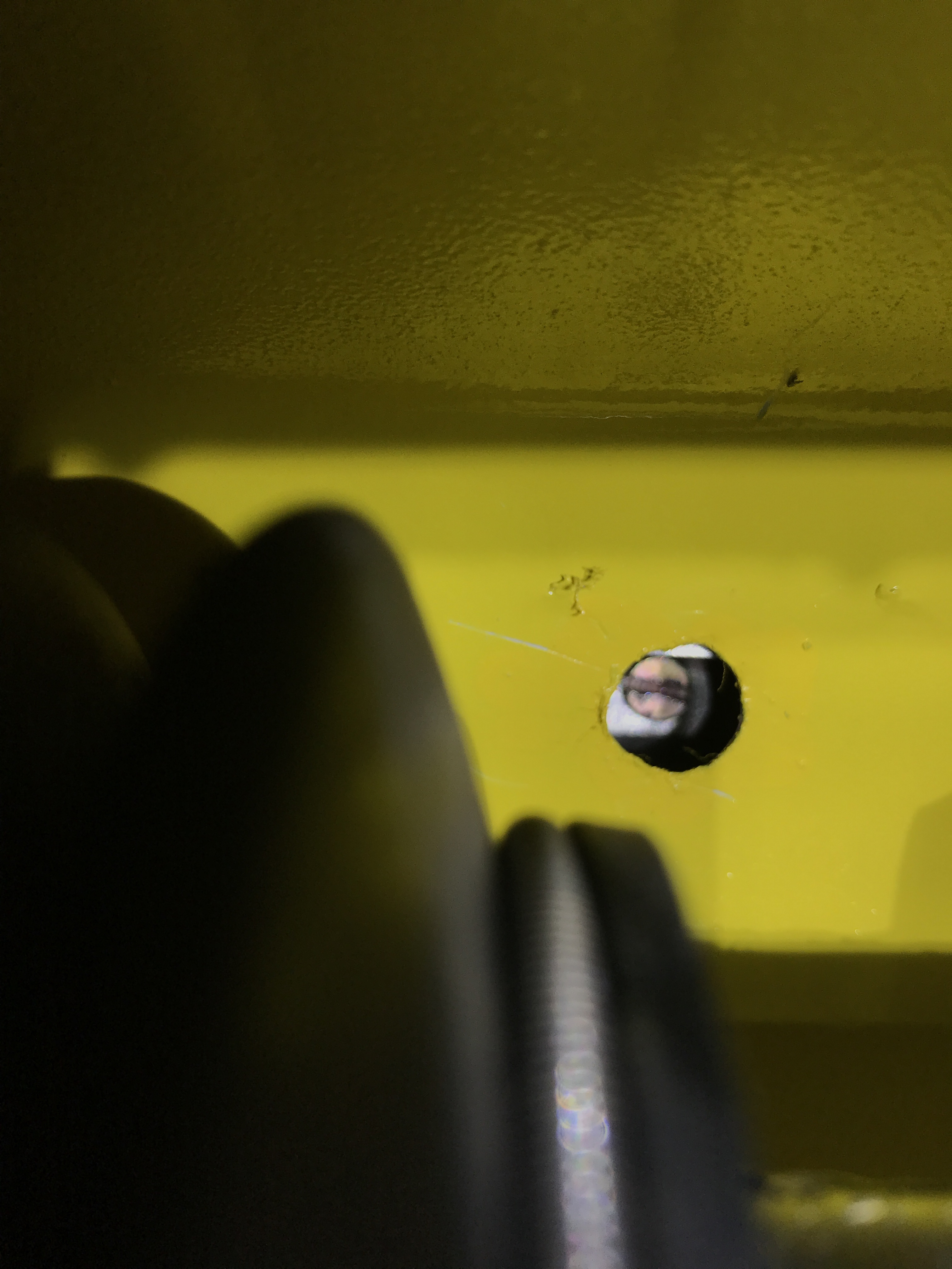

Thanks, everyone. I have gone ahead with my idea to mount the pump under the tank, on the right side, with a hope I can pull the pump if necessary through the big round access hole.
To make that possible I drilled a half inch hole in the "floor" above the steering rack. This allows a screw driver to reach the bolt on the pump clamp.

bkrantz   Here's the hole from above. More pics when I ...   Jan 25 2021, 08:11 PM
