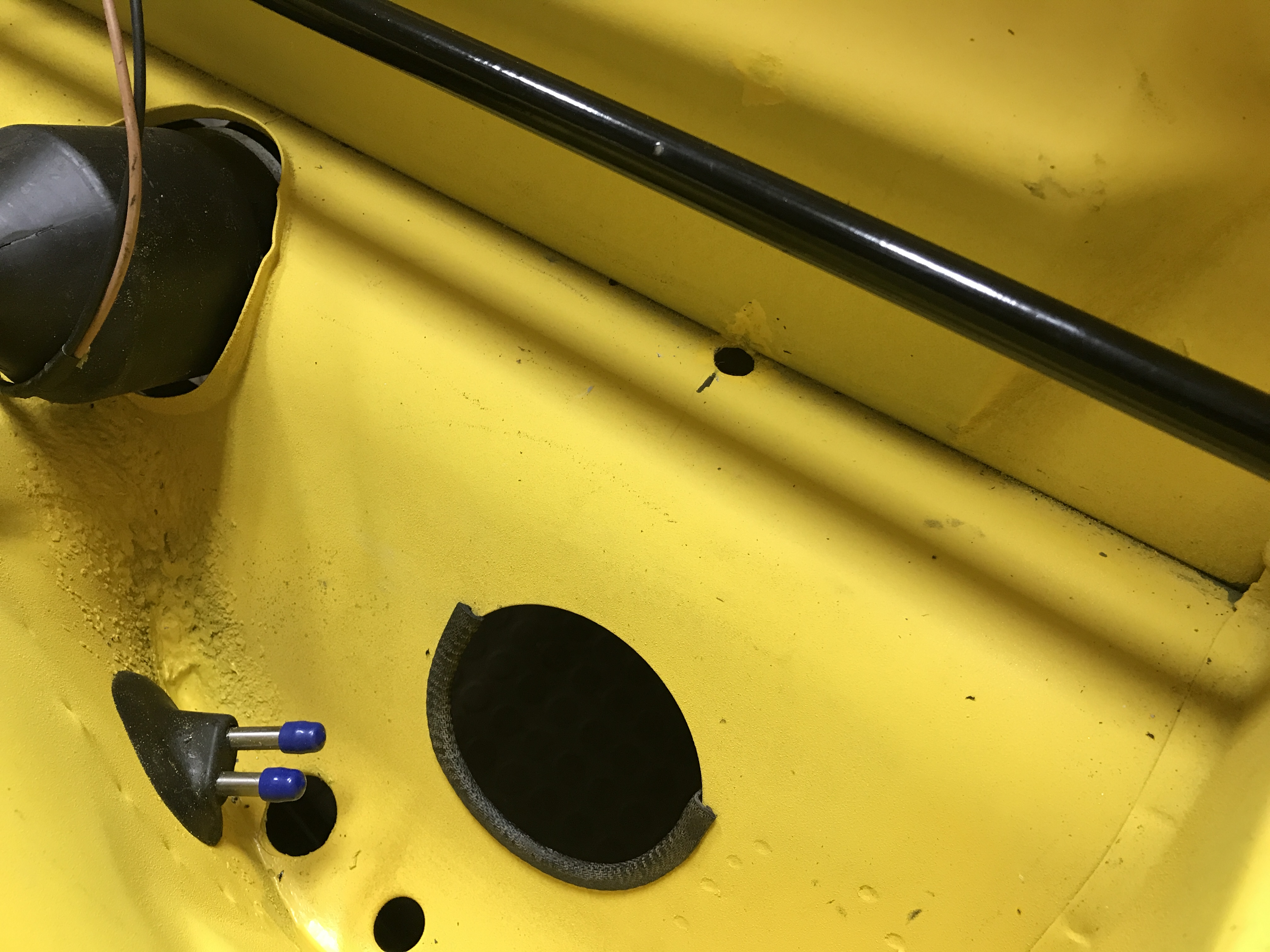

What do you all think of this location for mounting my new pump in the front?
Besides space, I have some other goals:
1. Avoiding mounting on any sheet metal shared with the passenger compartment.
2. As much protection as possible.
3. Short fuel line runs between the tank, filter, pump, and hard lines.
4. Access to the lines without pulling the tank.
5. Access to the pump without pulling the tank.
My proposed location probably does not satisfy goal 5 (maybe), but otherwise I like it.
bkrantz
post Jan 25 2021, 08:11 PM
Posts: 8,494
Joined: 3-August 19
From: SW Colorado
Member No.: 23,343
Here's the hole from above.
More pics when I get this done.

bkrantz   Thanks, everyone. I have gone ahead with my idea ...   Jan 25 2021, 08:09 PM
bkrantz   Here's the hole from above. More pics when I ...   Jan 25 2021, 08:11 PM
914_teener   What do you all think of this location for mounti...   Jan 25 2021, 08:17 PM
bkrantz   What do you all think of this location for mount...   Jan 26 2021, 09:02 PM
iankarr   Looks like a great spot. Only thing I’m curious ...   Jan 26 2021, 09:36 PM
914_teener   Looks like a great spot. Only thing I’m curious...   Jan 28 2021, 03:19 PM
bkrantz   Looks like a great spot. Only thing I’m curiou...   Jan 28 2021, 10:48 PM
