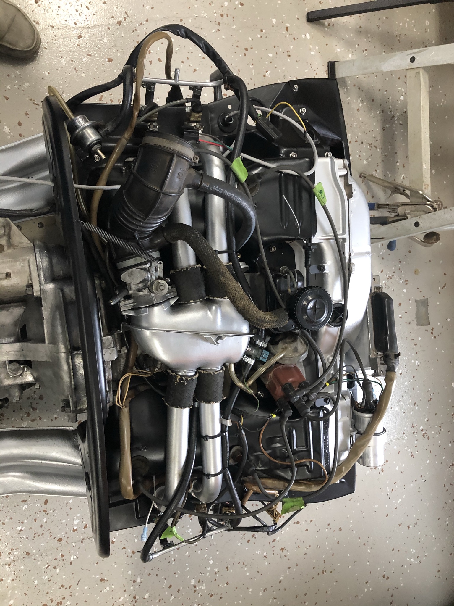

There is so much knowledge on here, these guys will get you walked through. I also have a 74 1.8 I replaced leaking seals, etc. I attached an overhead of the FI. If you need any pictures of where things connect, plug-in, etc. feel free to reach out. Attached Image

QUOTE(Mcraneiowa @ Jan 26 2021, 06:51 PM) *

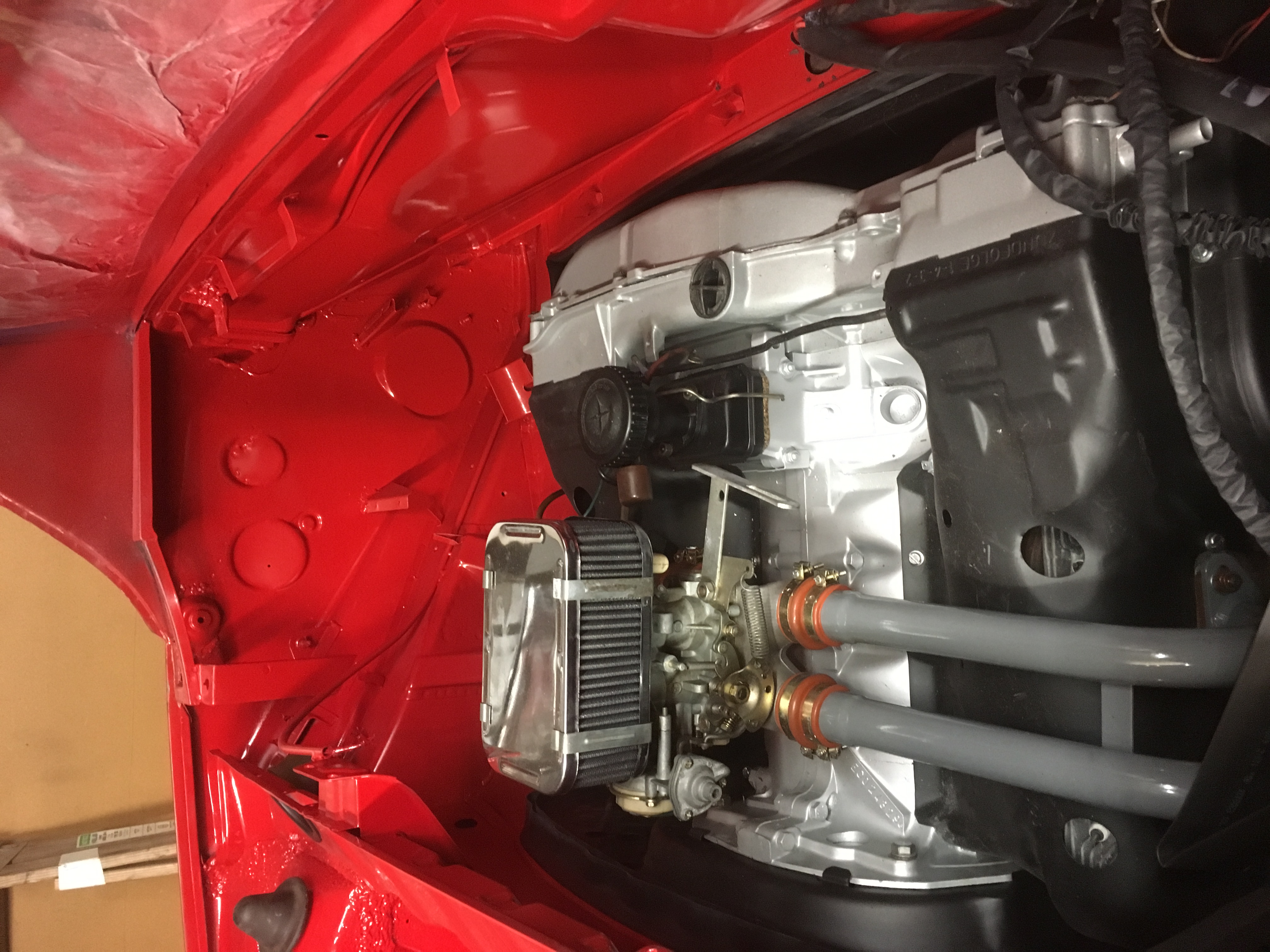

I’ll definitely take you up on that! I almost don’t know where to begin (but seriously I don’t know where to begin) hate installing things in the wrong order and shooting my self in the foot. Was going to start this endeavor this weekend. I’ve never seen a FI system on a 914 so it’s a little overwhelming and the Haynes manual is limited on pictures. I’ll shoot a couple pictures of brackets and stuff and ask locations. To bad a single carb doesn’t do the trick so simple, this is my starting point before pic minus some stuff (IMG:style_emoticons/default/av-943.gif) soon the engine compartment will be a jumble compared (IMG:style_emoticons/default/lol-2.gif) Attached Image
