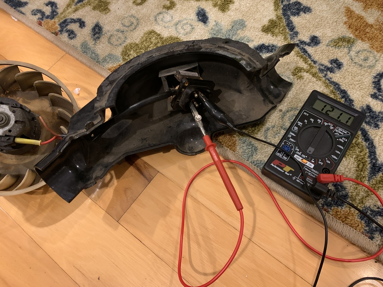

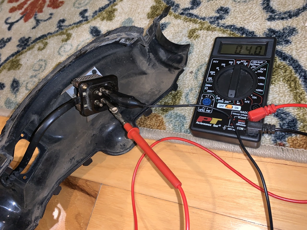

i went back and retested the resistors like you suggested, post to post same results, then i hooked up the motor to the leads, rechecked the low and medium we’re about same , the high on the other hand was like 121?? here are pictures-
the high post is the one with red wire(+) that goes to motor, from motor that brown ground wire (-) goes back to the resistor pack so the black lead is on that post for each test.
i did not bench test the motor with 12v but i can tell you it’s difficult to turn by hand it’s not freely spinning, housing is apart and the fan seal broke and no one makes them yet- hey Mark! @Mikey914 (IMG:style_emoticons/default/poke.gif)

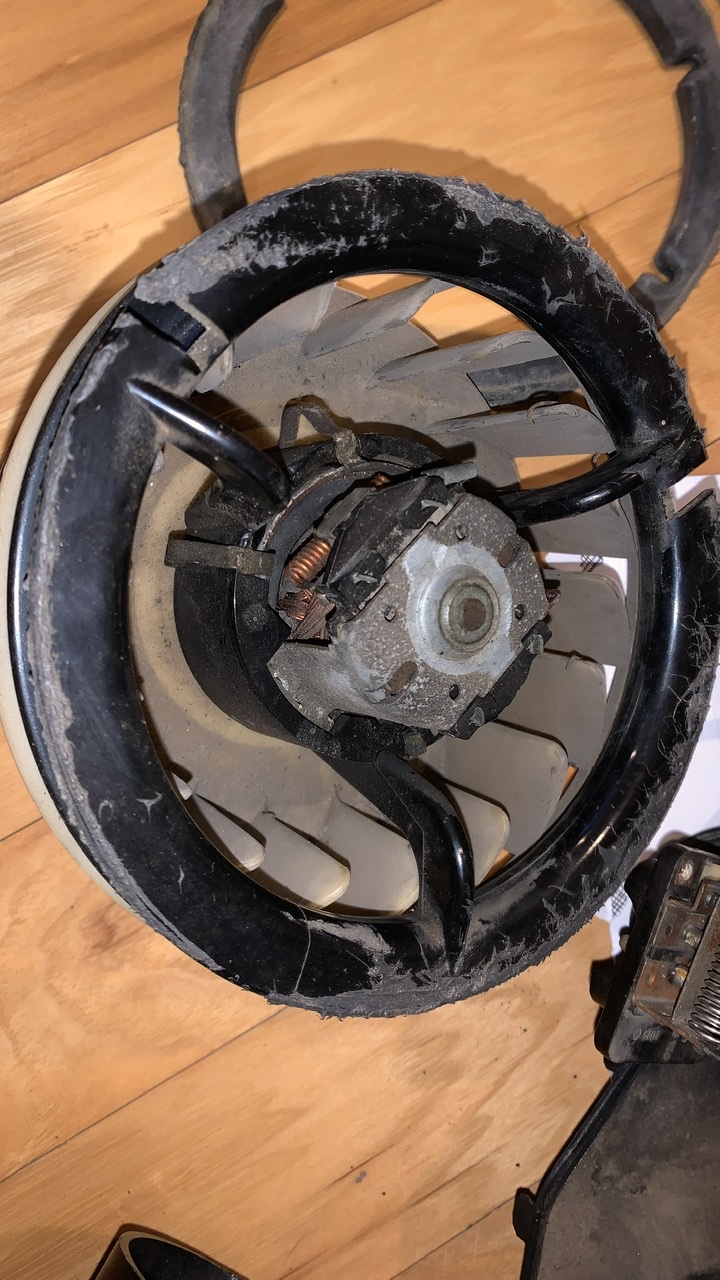

also pictures of the fan motor assembly, it’s now out. it’s different than the new ones, they don’t have the metal housing like this. anyone order one of the new ones from URO or Porsche?
how do you take the motor out of the white fan part? i took the black top part off by taking the 3 spring clips off that hold those 2 parts together - the black part holds the big seal .
