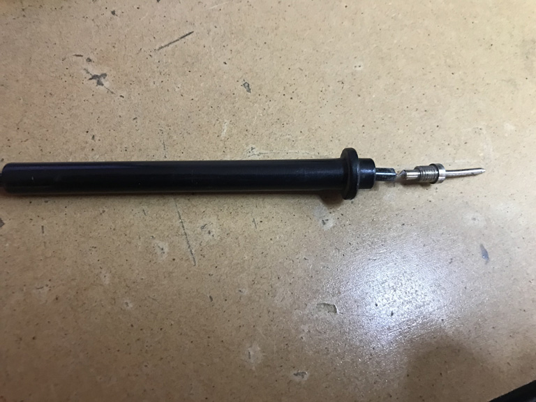

I'm a little leary of your meter given that very 1st round of measurements measured 0.8 ohm on everything and now things are measuring much better for the medium and low resistors but way, way off for High. Something very odd going on here. We're going to stay here for a bit until we can 1) verify your meter is OK, or 2) Get repeatability to the readings, or 3) find some other root cause that explains all this weirdness.
Ideas to move forward:
1) Are you abslolutely sure the meter leads aren't having connectivity issues of their own? I've had leads similar to yours, where you can unsrew the plastic lead housing from the metal tip, and the lead wire is soldered to the test tip. I've had bad solder joints on these type of leads before. Beware of these type test leads.
a) I'm going to assume this isn't likely and that you performed the low and medium measurements after doing high and getting 121 ohm on high and by measuring 4 ohm type connections on M & L immediatly following the 121 ohm we can be partially convinced the problem isn't in the test lead.
2) When you did measure the high postion is there any chance the aligator clip wasn't making good connection on the high post? If you tried wiggling the aligatior clips to scratch the post and/or pressed the clip together while wiggling to get though any post corrostion and you measured 121 ohms multiple times, we'll assume it wasn't a fluke of the connection of the test lead.

DRPHIL914   i am going to get new leads, yes mine pulled apart...   Jan 27 2021, 01:24 PM
