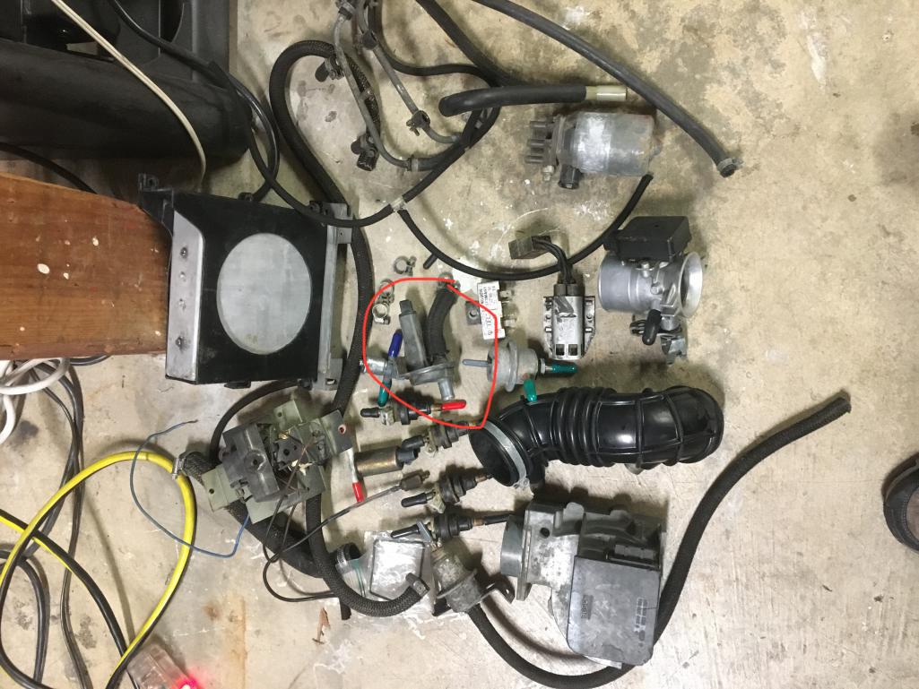

The PO had a single carb on when I bought my 74’ 1.8 914 and said he had uneven idle problems with the L-jet injection so he preceded to remove all components and box everything up. So now I’m feeling I want to reinstall the injection and put it back to stock. I have some mechanical ability and patience, though I was never able to get that gas smelling carb to run right. Was looking for someone I could pay for a few hours to kinda orientate me on the location of the box of injection parts I have and give me thoughts on what parts I might be missing and how difficult and expensive it will be to put everything back. I’m in Puyallup WA south hill area, Thanks In advance

Let me know what pictures you need. The engine with L-Jet from Betty's car is sitting on a stand in my garage. So pictures will be easy to get right now.
Do you have the bracket and Aux air regulator? I didn't see it in your pictures.
Clay

I thought I had the regulator and I have a black bracket it’s in the photo with my plenum and Gray intake runners
AAR in the middle of your picture.
