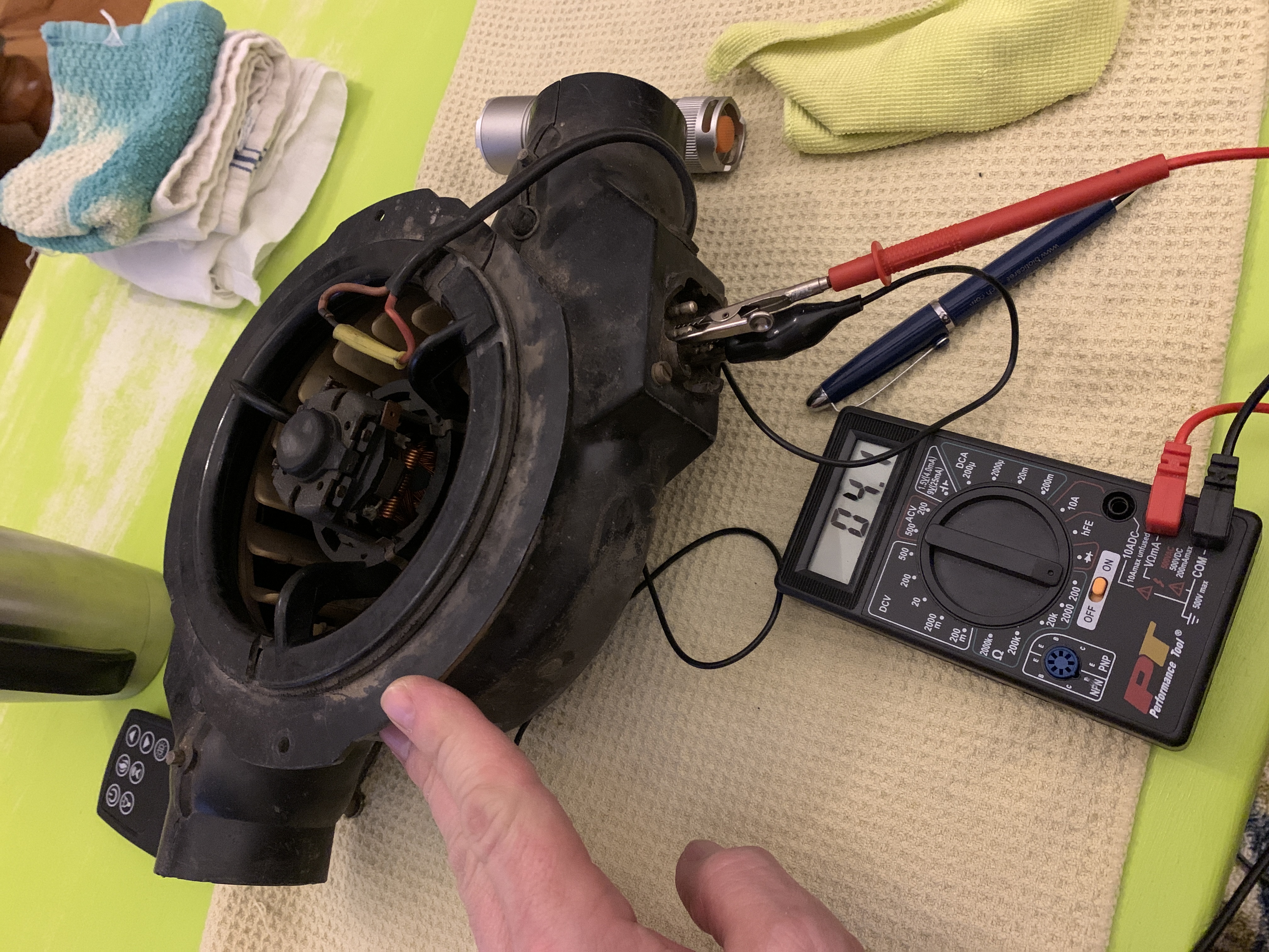

I have been dealing with this for 12 years, a non-running defrost fan. i even pulled this out 2 years ago and rebuilt it with new flapper seals and main body seal then made sure fan turned but didnt bench test the motor or resisitors, so as a result it still does not work properly. i will be documenting this because 914rubber and Mark will soon be putting together a kit for this that includes all the hardware seals and even a motor i believe, BUT i still have problems and questions!!! so i am starting this thread to get information on diagnosing the common causes of it not working and how to fix it, and then document the rebuild and replacement of the motor, fan, resistor and maybe the control unit in dash. Others have documented the reinstallation of the fan and the cables so i will not duplicate that. and we may want to link other threads hear that have done that as well.
Mark is sending me a kit soon, so while i wait for it, i will have to get some more information about the wiring and resistors function and how to test them .
I had this out last week and tested 3 different control units due to thinking that my issue was a control issue, because it runs on one speed, #2, and anything else does not work and it will then throw the fuse. most assume this would be caused by bad slider unit but i tested 3 of them and 2 are like new with no wear on the sliders , still same result. so i am suspecting the resistors /plug aparatus .
If anyone has done this and cares to share how to examine and test that for proper function, lets start there.
Resistor function, which lead is which and examination of the control units
I will take pictures of mine tonight and post those soon. once this figured out and fixed i will do a full step bystep on reassembly too.
Looking for lots of help and input on this, thanks!!!

i went back and retested the resistors like you suggested, post to post same results, then i hooked up the motor to the leads, rechecked the low and medium we’re about same , the high on the other hand was like 121?? here are pictures-
the high post is the one with red wire(+) that goes to motor, from motor that brown ground wire (-) goes back to the resistor pack so the black lead is on that post for each test.
i did not bench test the motor with 12v but i can tell you it’s difficult to turn by hand it’s not freely spinning, housing is apart and the fan seal broke and no one makes them yet- hey Mark! @Mikey914 (IMG:style_emoticons/default/poke.gif)
also pictures of the fan motor assembly, it’s now out. it’s different than the new ones, they don’t have the metal housing like this. anyone order one of the new ones from URO or Porsche?
how do you take the motor out of the white fan part? i took the black top part off by taking the 3 spring clips off that hold those 2 parts together - the black part holds the big seal .

i just got the new blower from Al and the fan is free and clear and spins smoothly.
just tested the static resistance and i get, 2.6 & 4.4 but on the high circuit 2.5 with motor hooked up. without motor in the circuit, it’s 2.8 low, 4.2 medium and 1.7 high,- looks like low and medium should be switched, i am sure i have the contacts located correctly.- also tested between each circuit, so those were
5.2 between low-medium posts( the 2 resistors combined?) 4.6 low-high, 2.8 medium-high, . do those number look better than the other fan?

DRPHIL914   i’ve had this apart for some time and finally ha...   Feb 14 2021, 09:51 PM
DRPHIL914   after polishing , overkill i know but might as wel...   Feb 14 2021, 10:03 PM
DRPHIL914   UPDATE: finally got around to installing this ne...   Mar 23 2021, 08:19 AM
DRPHIL914   tank up and box accessed- pretty clean under there...   Mar 23 2021, 08:24 AM
bob164   Don't think this is the issue with the fans, b...   Mar 23 2021, 02:39 PM
DRPHIL914   Don't think this is the issue with the fans, ...   Mar 24 2021, 04:59 AM
bob164   The picture isn't that clear, was referring to...   Mar 24 2021, 11:22 AM
DRPHIL914   The picture isn't that clear, was referring t...   Mar 25 2021, 06:39 AM
DRPHIL914   ok update from trouble shooting last night, after...   Mar 25 2021, 06:52 AM
Rob-O   Quick question and I don’t have a schematic in f...   Mar 25 2021, 07:27 AM
DRPHIL914   Quick question and I don’t have a schematic in ...   Mar 25 2021, 10:22 AM
DRPHIL914   OK finally last night i was able to sort thru the ...   Mar 26 2021, 08:25 AM
DRPHIL914   this is how the wiring should be connected. i am ...   Mar 26 2021, 08:35 AM
