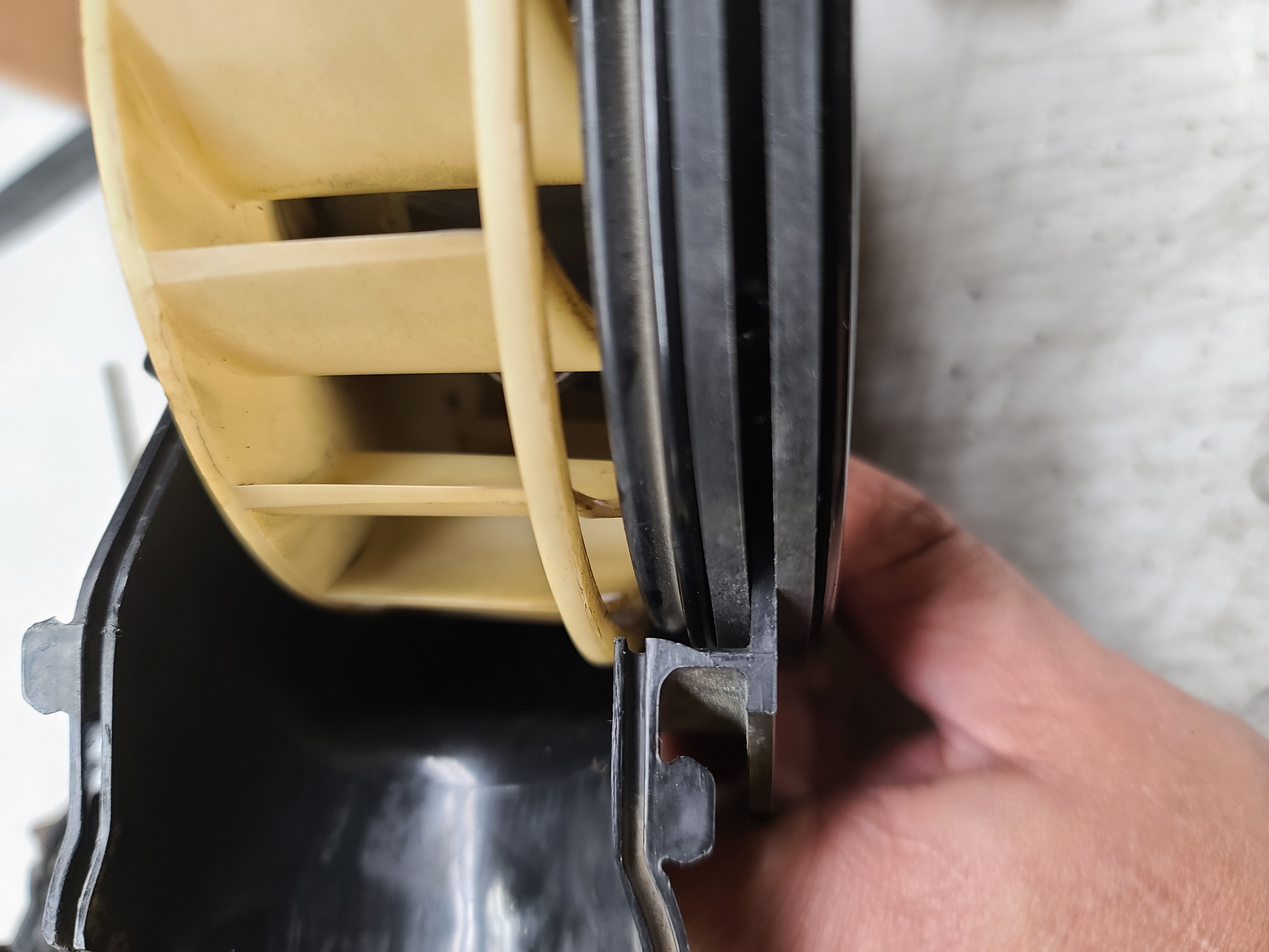

DRPHIL914   i’ve had this apart for some time and finally ha...   Feb 14 2021, 09:51 PM
DRPHIL914   after polishing , overkill i know but might as wel...   Feb 14 2021, 10:03 PM
