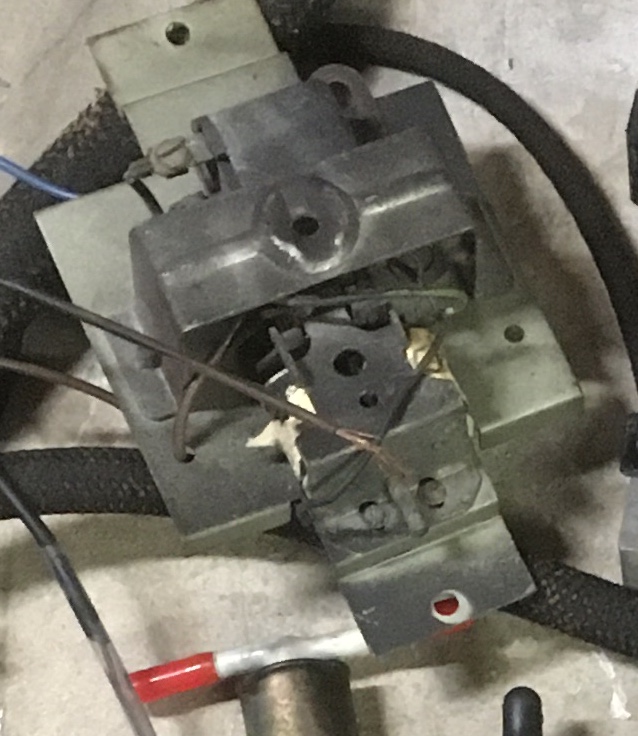

I’m thinking this part? in the picture had a cover and I was told I need a thermo-time sensor. So I’ll be looking for these items as well as anything else I don’t have.Attached Image

QUOTE(shane @ Jan 27 2021, 03:40 PM) *
That is not part of any L-Jet system I have ever seen.
