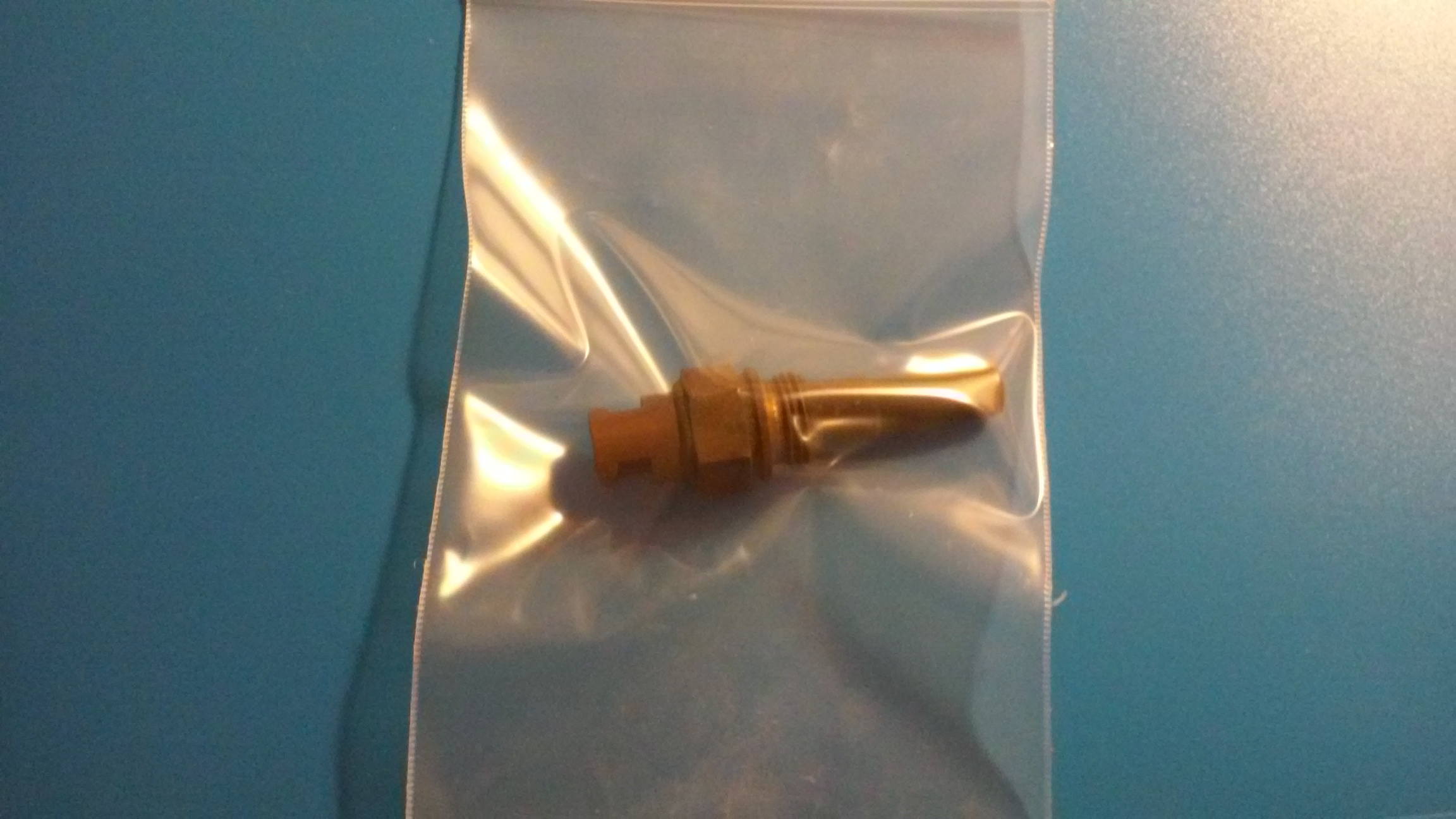

QUOTE(shane @ Jan 28 2021, 05:34 AM) *
QUOTE(ClayPerrine @ Jan 28 2021, 03:51 AM) *
That is not part of any L-Jet system I have ever seen. Clay
Here is a L-jet Thermo-switch (sans brkt)

shane   I’m thinking this part? in the picture had a cov...   Jan 27 2021, 03:40 PM
ClayPerrine   I’m thinking this part? in the picture had a co...   Jan 28 2021, 05:51 AM
shane   I’m thinking this part? in the picture had a c...   Jan 28 2021, 07:34 AM
wonkipop   think what you call thermo time sensor would be th...   Jan 28 2021, 04:59 PM
914werke   That is not part of any L-Jet system I have ever...   Jan 28 2021, 05:25 PM
