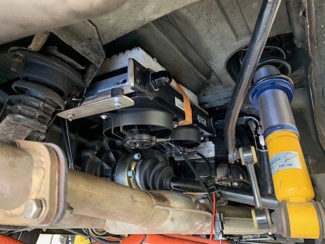

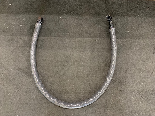

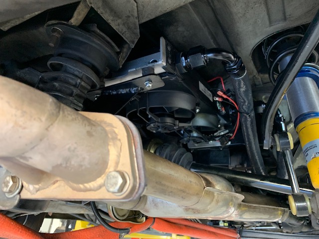

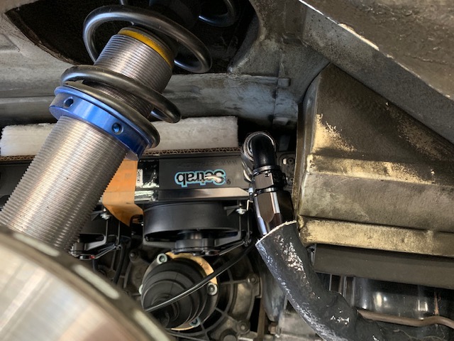

After running the car around a bunch and never being happy with the oil temps I added a thermostaticly controlled oil cooler with fans that are also controlled by a thermostat.
I am lazy and do not want to be bothered trying to remember to turn fans on and off.
Besides in my mind this is the correct way to do it.
I also added some 2.0L SSI exchangers. They are much better as everyone knows.
