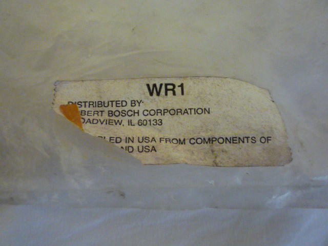

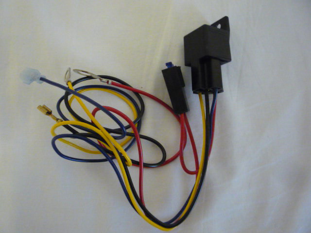

Another option is Bosch WR1 starter Kit. $27-$36 depending on where you shop

914Sixer   Another option is Bosch WR1 starter Kit. $27...   Jan 29 2021, 10:03 AM
