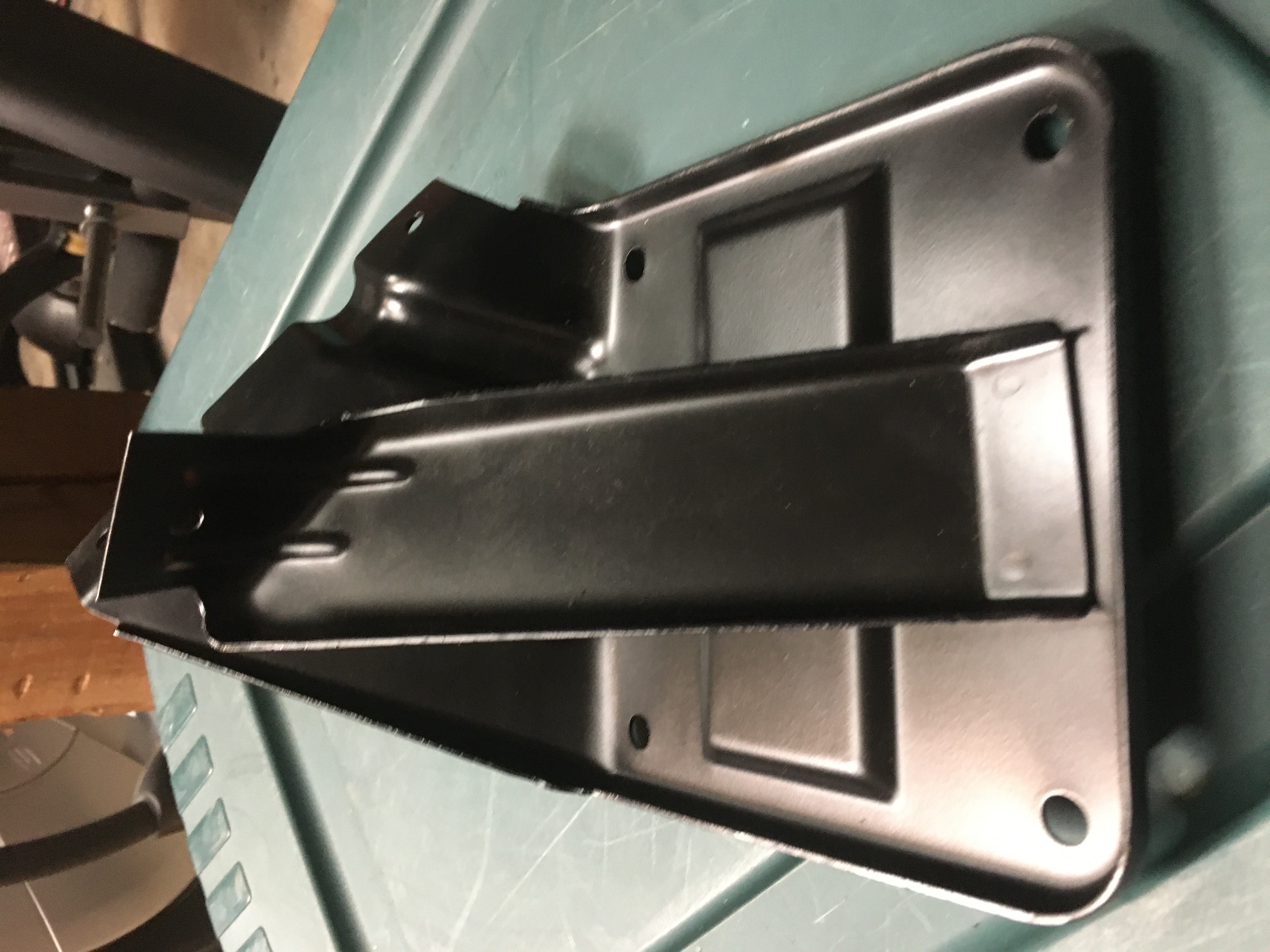

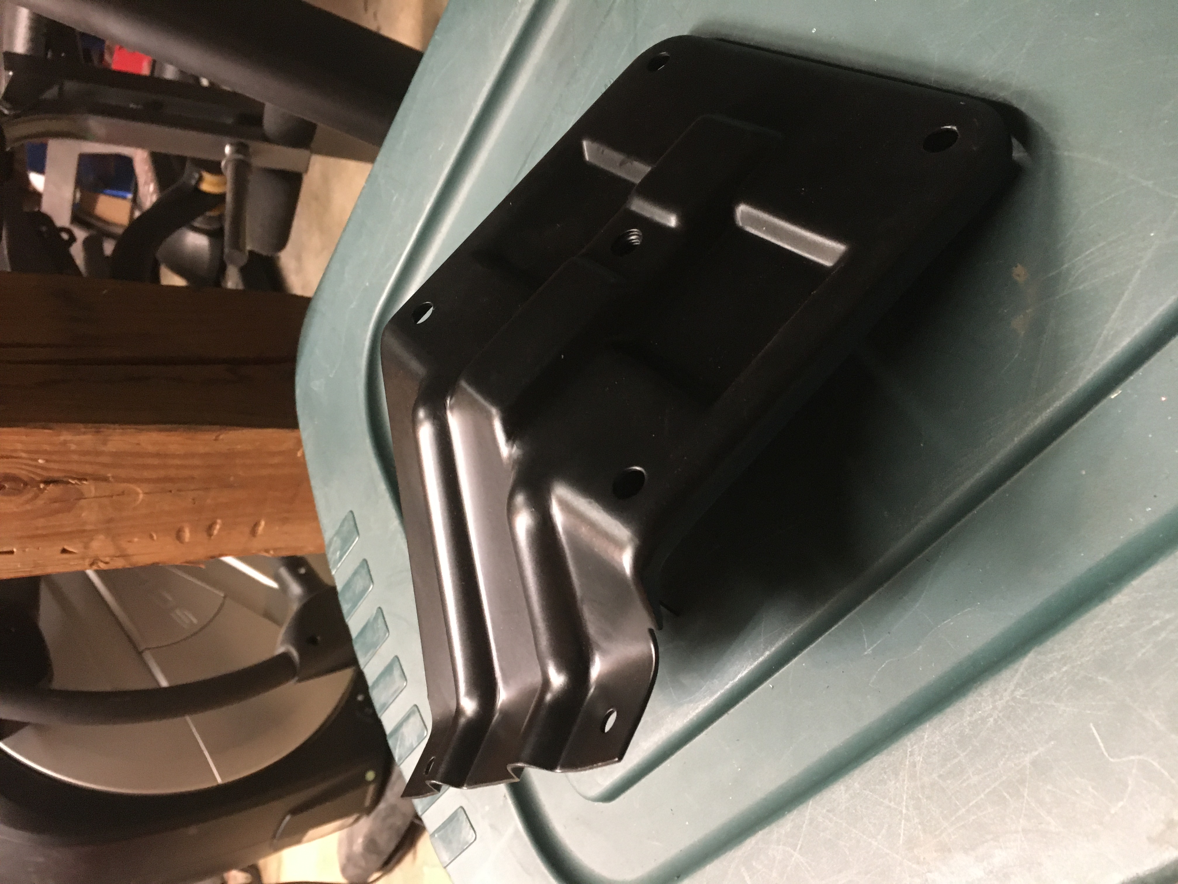

Thank you so much that’s exactly what I needed to try and get started. Does the underside of the plenum bolt down? And where does this bracket go? Hoping that once I get some of the big pieces of the puzzle together it will get much easier (IMG:style_emoticons/default/beerchug.gif) Attached Image Attached Image

wonkipop   nice images of a beautiful build mr. m. can see t...   Jan 29 2021, 08:22 PM
shane   I definitely have to powder coat my plenum silver ...   Jan 29 2021, 08:28 PM
wonkipop   that is your air cleaner bracket. mounts off the ...   Jan 29 2021, 10:05 PM
