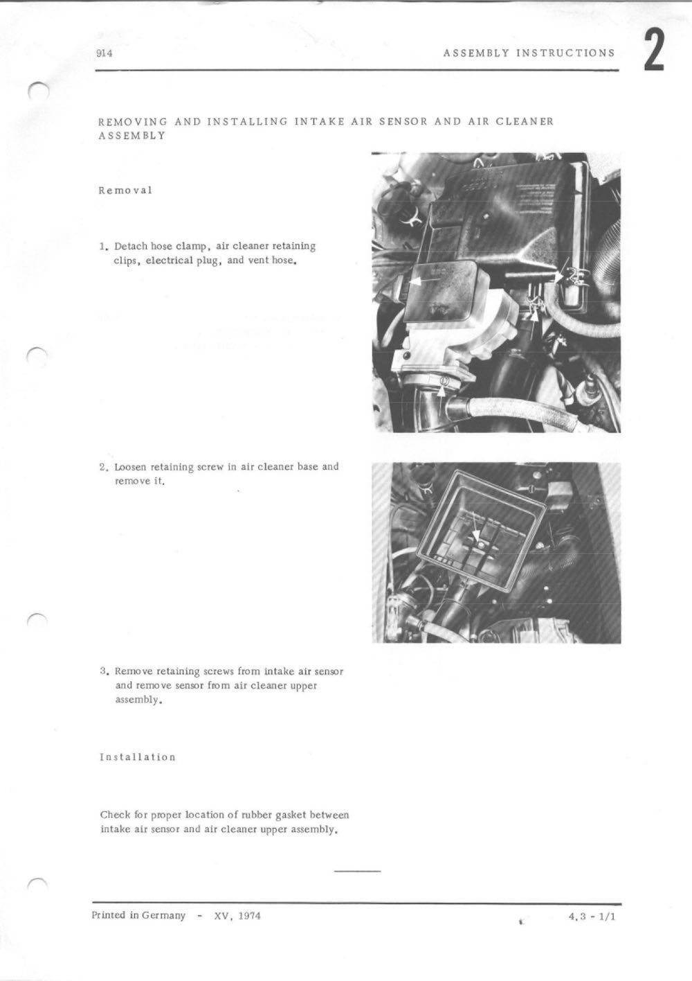

that is your air cleaner bracket. mounts off the body if i remember right.
