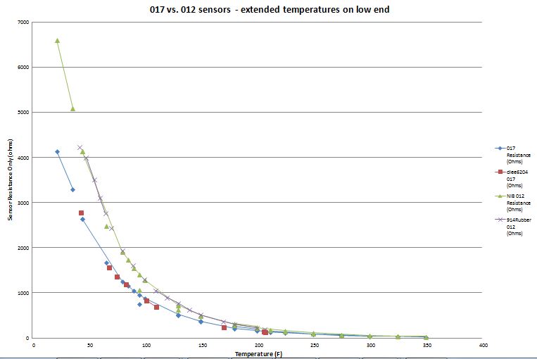

I missed out on 8 degree F temp this morning. By the time I got my act in gear it was 22F.
I'll keep updating this post as I am able to add lower and lower temperatures as the weather permits.
