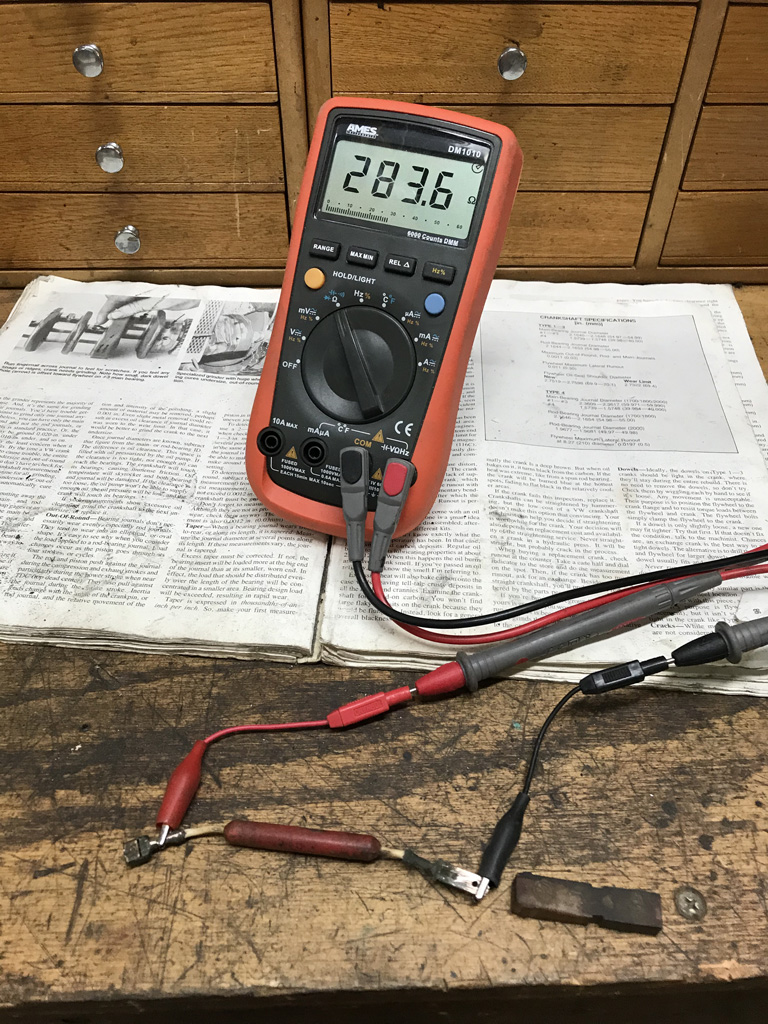

I recently acquired a NOS temperature sensor for the one year only '73 Djet system 0 280 130 017. This sensor has been NLA for a very long time and finding a used one is very difficult. Given the rarity there isn't a lot of information on the proper resistance values of this sensor. Pbanders (https://members.rennlist.com/pbanders/DJetParts.htm) lists three data points for the resistance of this sensor but I thought I would post my findings. I also listed the values of the aftermarket sensor 0 280 130 012 available from 914Rubber.
@Superhawk996 This answers some of your concerns.

Just added to other thread on what the CHT resistor looks like so I'll repost here too.
Spec is 270 Ohms and is probably typical +/- 10% to 20% tolerance for non-precision resistors.
Per Brad Anders site he lists them as 1/4 - 1/2 watt whichs seems very plausible given no significant current flows through the CHT sensor itself.
