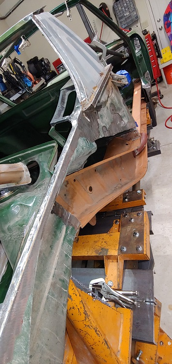

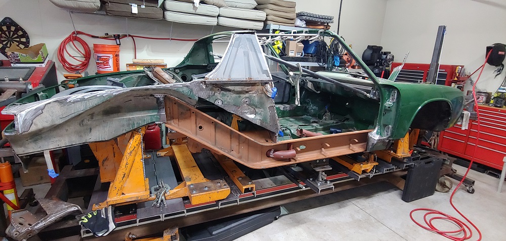

Well it's gotten to be that time finally. I've been collecting parts to do the repair on my 914-6 and now the work starts. The main issue is the hell hole/inner engine long, inner pass long, pass inner rocker panels are rusted out. The last part I was trying to source seams to be NLA. I sourced most of the parts from the good guys at Restoration Design. I received my order today for the last batch of things. Based on a few threads that I've looked over the outer shell to the inner engine long is currently not being made by RD. A few guys have made their own which looks like a real pain in the rear to do. I laid out all the new metal to see how things lined up. By the looks of things it will need some fine tuning to mate things properly. Before I start cutting into the chassis I'll build a few braces to keep things true.
Time for the pics...
Attached Image Attached Image Attached Image Attached Image Attached Image Attached Image Attached Image Attached Image Attached Image Attached Image Attached Image Attached Image Attached Image Attached Image Attached Image Attached Image

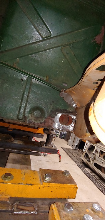

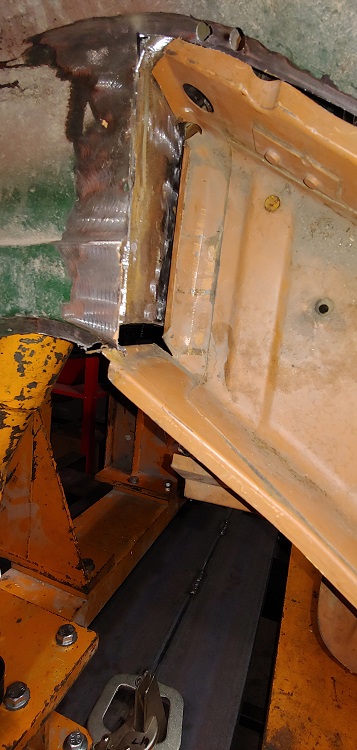

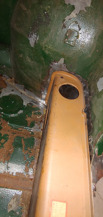

Hi Rory,
Working away for sure. I'd like the car in paint by May. I know I can , I know I can...lol..
I move the Cayenne outside when I grind/weld. And yes I make a pretty good mess but I also like my garage as clean as possible..lol..
Test fitted the long. Needs some fine tuning but overall fits well.
Taking a lunch break then back to it. (IMG:style_emoticons/default/beer.gif) (IMG:style_emoticons/default/beer3.gif)
