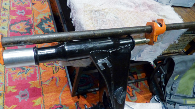

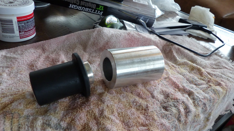

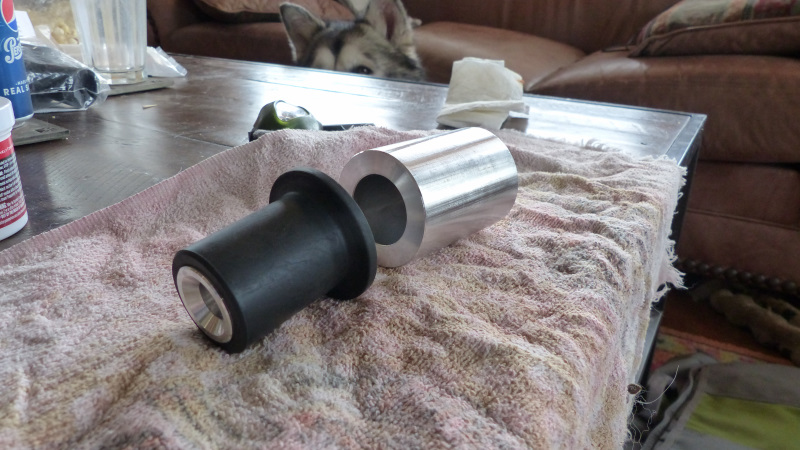

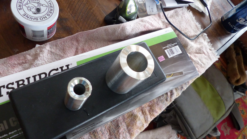

Of course! Here are the two tools. Nicely made but honestly, I think they would work just as well if they were hard plastic like the 914Rubber A-arm bushing tools to reduce cost.
Here are a couple shots using a poly/graphite bushing to show how they work. The small tool gets pressed into one of the bushings and the pivot shaft is pressed in through the opposite bushing. When the shaft meets the bushing with the tool in it, the conical bevel centers the threaded portion of the shaft to align it to follow the tool through the bushing. The large tool acts as a stop to prevent pushing the bushing out of the trailing arm and is hollow to receive the small tool as it is pushed back out of the bushing by the pivot shaft. Works pretty slick.
Here's a pic of them in action.
