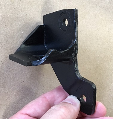

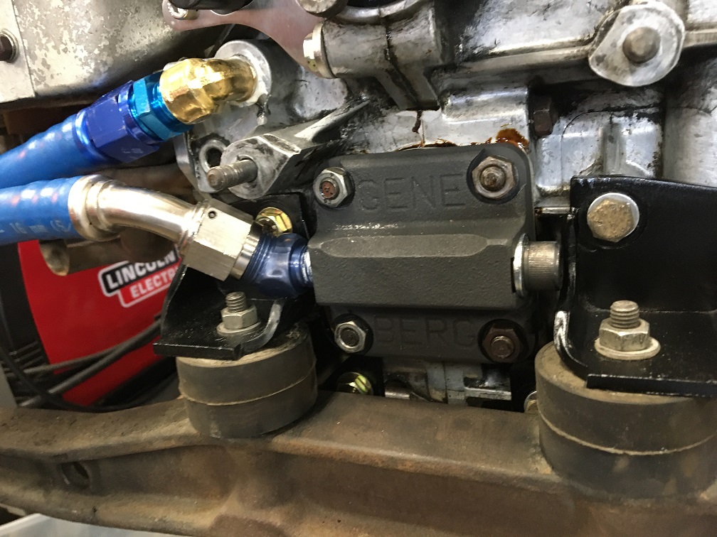

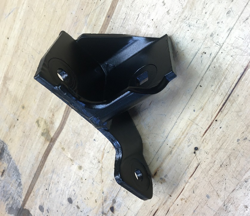

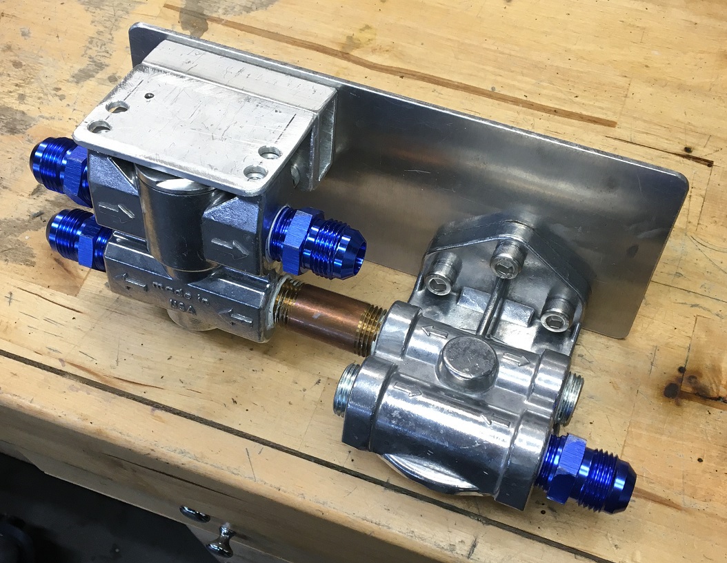

I will be using a 30mm Shadek pump and a Gene Berg full flow cover with pressure relief (Mark Henry's recommendation (IMG:style_emoticons/default/smilie_pokal.gif) ).
I modified both engine mounts as minimally as possible, but I recommend Mark Henry's mounts.
This will lead to my remote filter and thermostat sub assembly that will be bolted to the lower firewall on the driver side, then to the front cooler.
