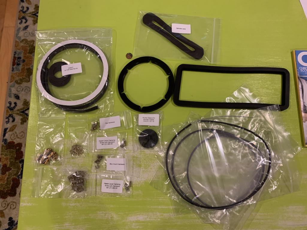

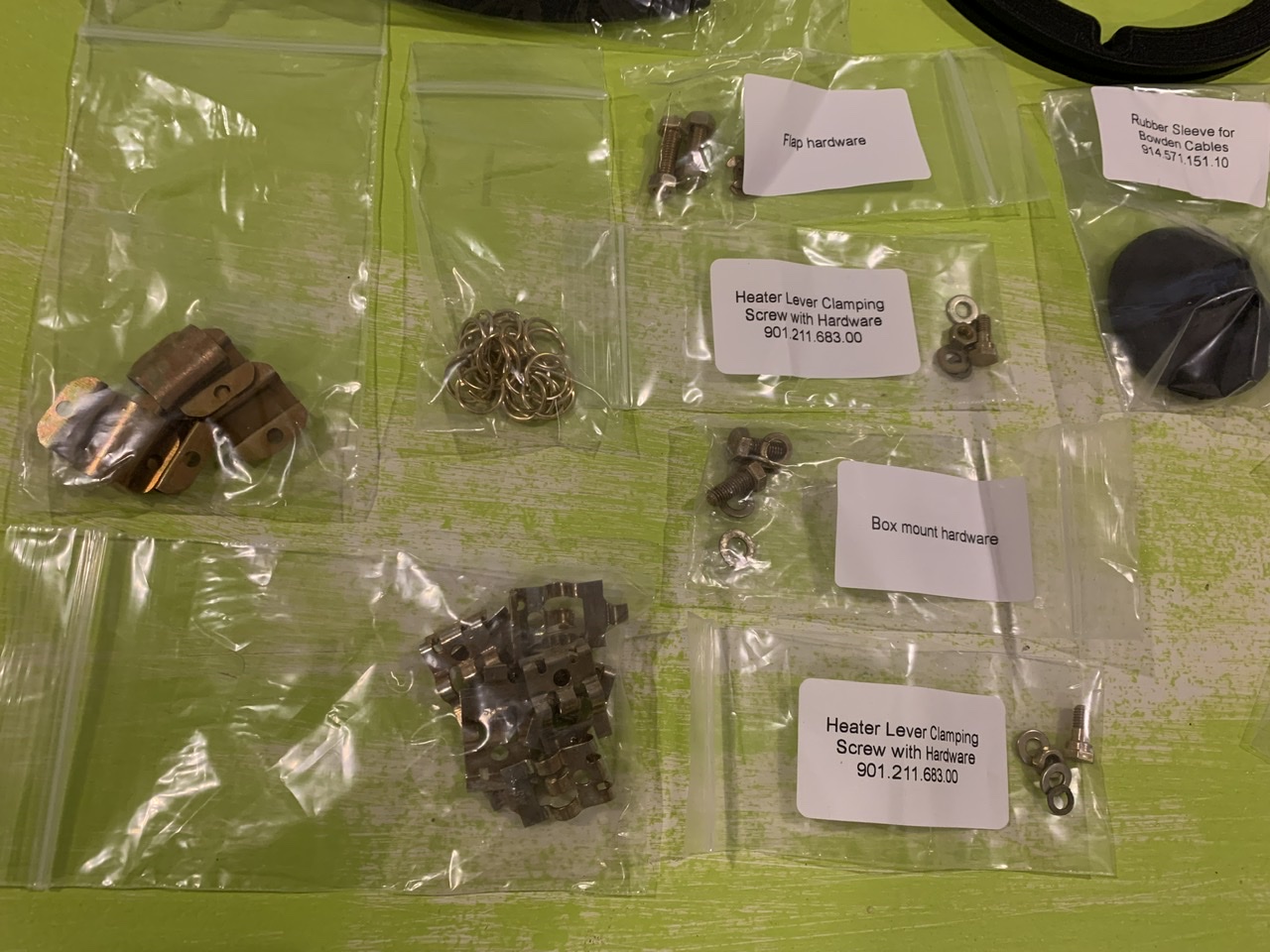

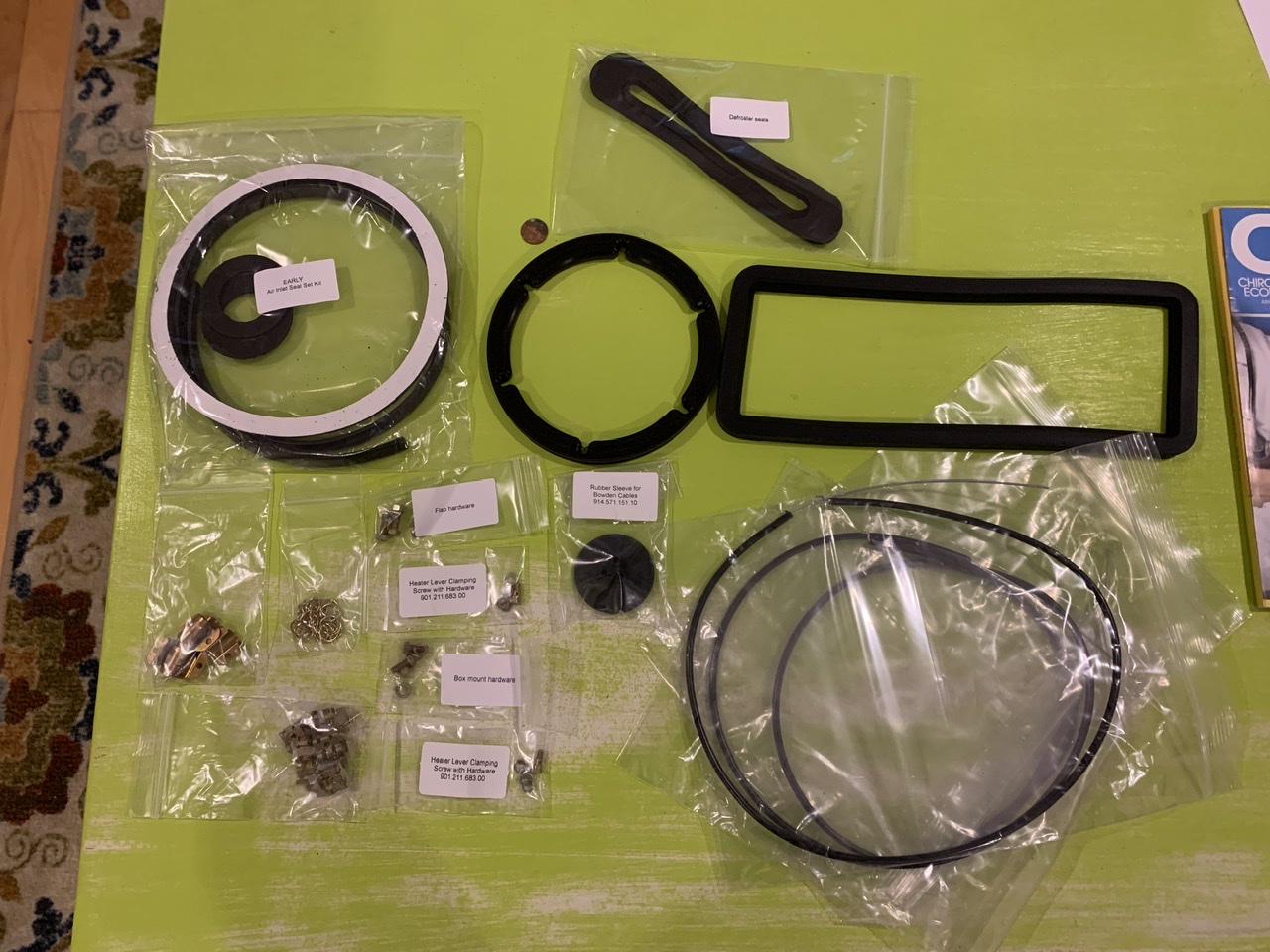

@Mikey914
@Superhawk996
here is my first batch of hardware and seals from 914rubber!!
now the fun can begin- i will need a second set of stuff to do the other box, but i am going to install a brand new fan into one unit, and a known good oem one in the other.
both need all new seals and will have a nice clean and restored fan housing (lowered half) i need a replacement top half if anyone has a mint one please PM me it’s the late type with the screen, the air/ water diverter part.
tonight i will do one rebuild and post the pics of the during and after .

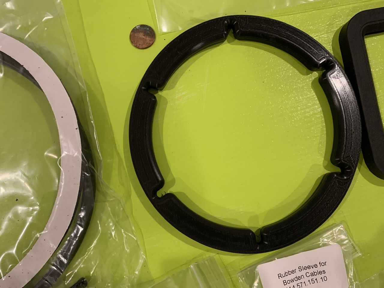

- first pic is of the fan seal no one makes until now! all the ones i have opened had these seals in very poor shape, it’s a porous seal not solid like the new 914rubber seal.
Thanks again Mark and Matt!
