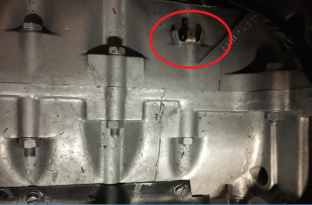

I'm pretty sure it was engine case, plenum then a nut. If the rubber lines are hard and brittle, it would be a good time to replace them. Go ahead and replace them with the slight radius style, it came that way from the factory. Lastly, make sure you clean these terminals that I circled in the picture. A bad connection here will cause a bad day of troubleshooting in the future.

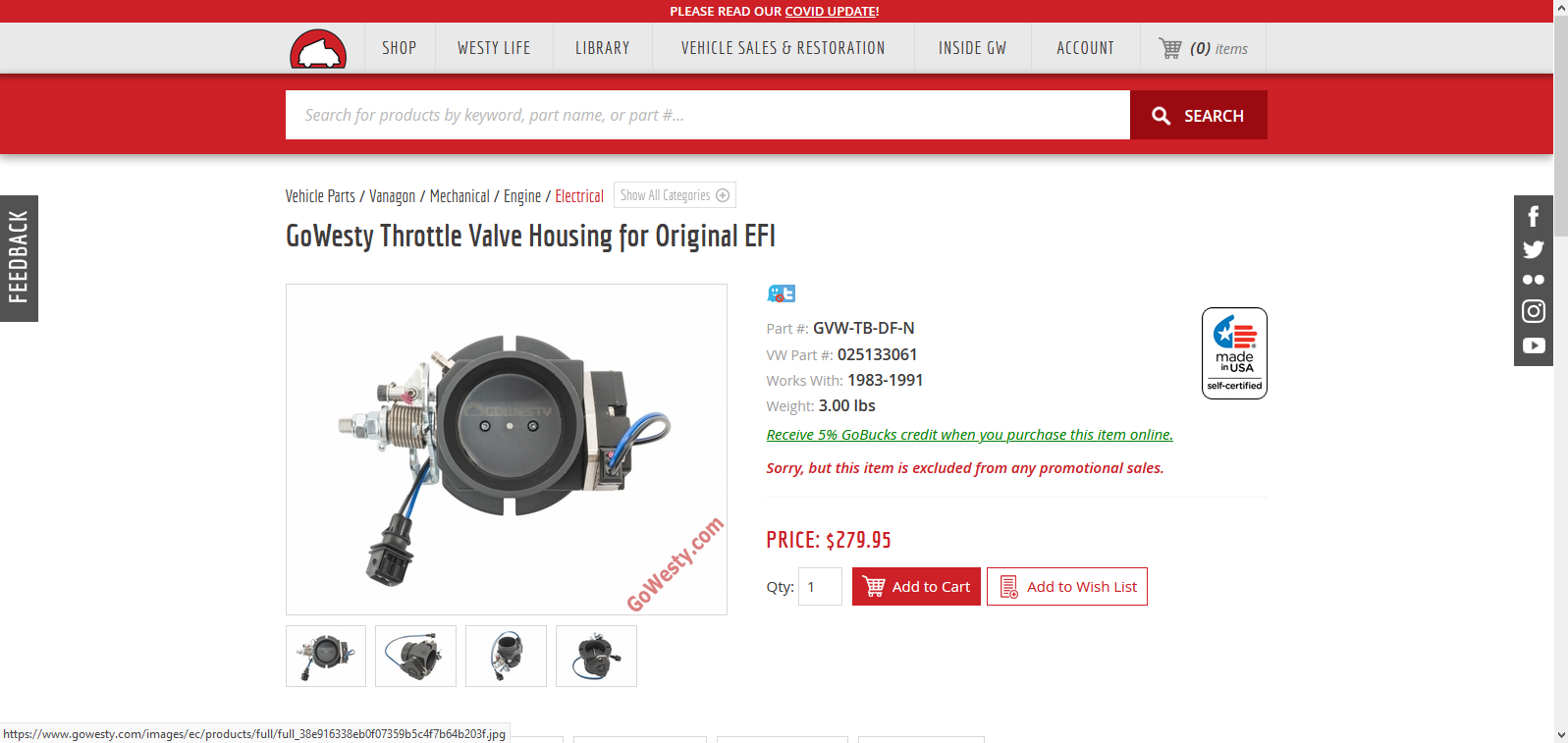

A slight highjack with this thread and perhaps Clay or others might chime in. I'm planning on going with the vanagon throttle body conversion. I think I found a cheap enough 50mm throttle body and have done research on good double sealed INA needle bearings to rebuild this potential 50 mm throttle body. However, I came across this GoWesty throttle body. Will this bolt up and play nice with our 1.8L's I do understand I'll have to fabricate something for the throttle body switch.
