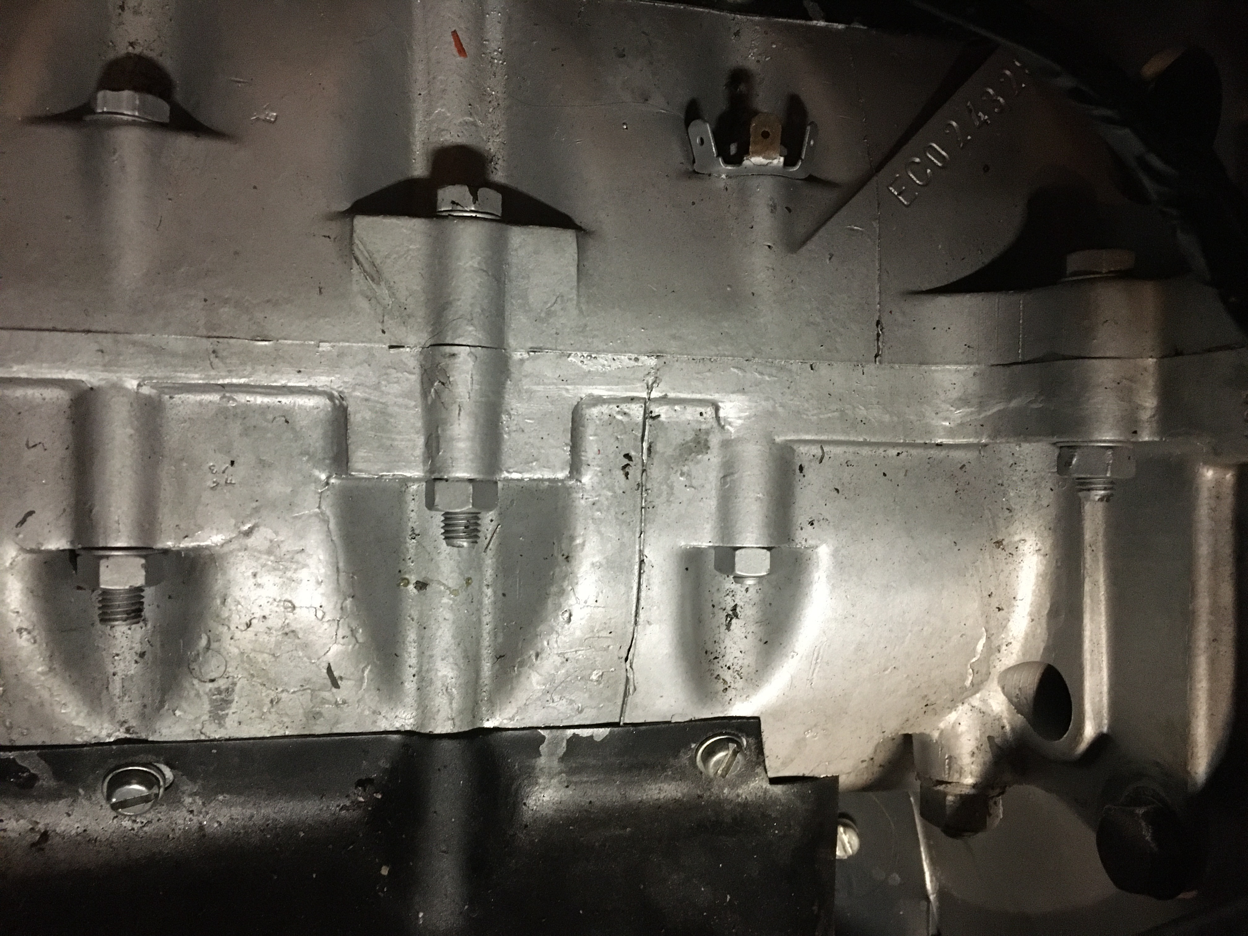

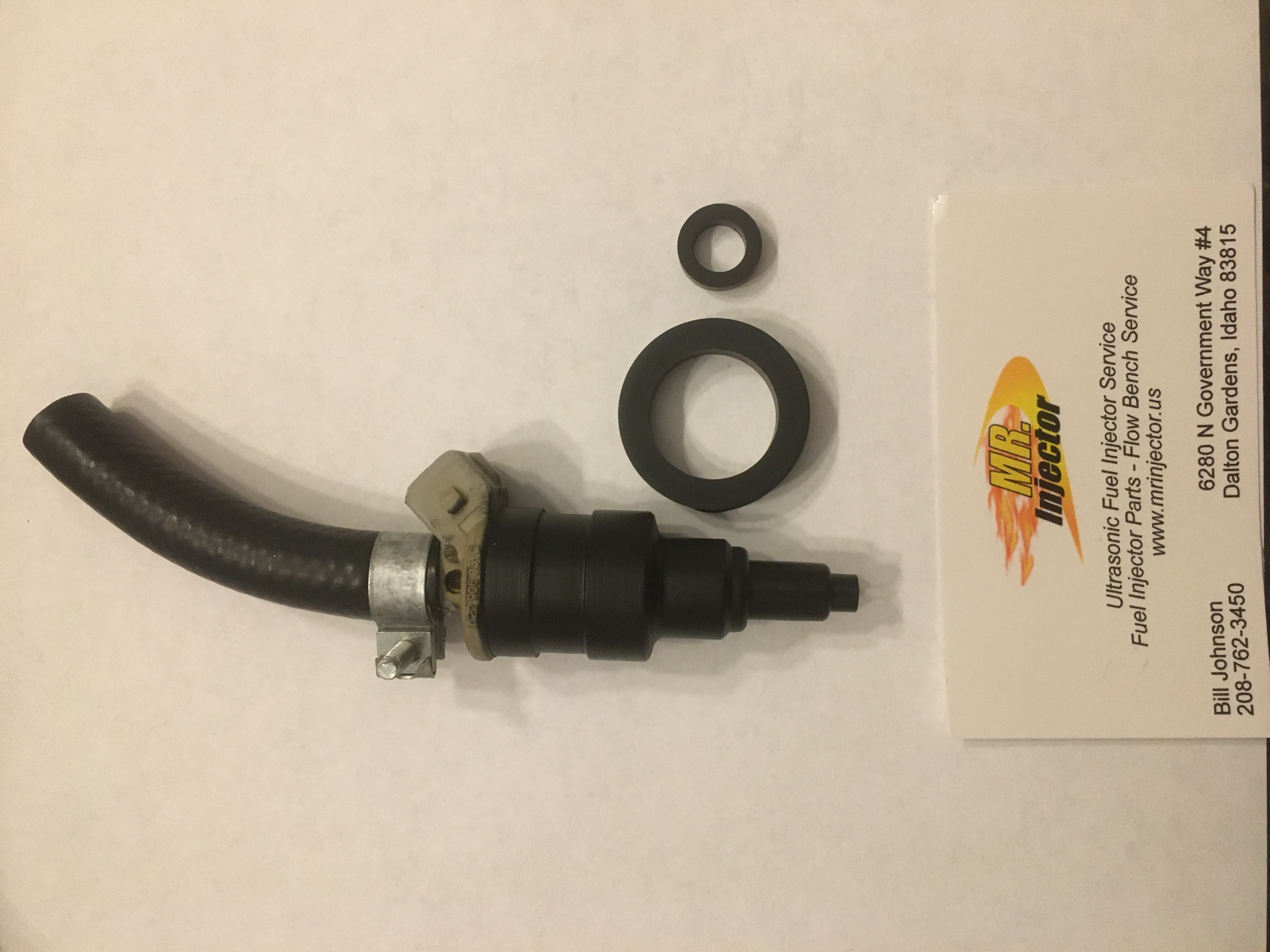

Received my injectors back, the hoses are pretty straight and hard to bend will that be to much stress on the injectors? I have most of the gaskets and stuff needed to install now. The plenum lines up with the studs on the case but I don’t know if the front stud has a nut on it then another one for the plenum? Also I’m missing I think a harness strap and something else that mounts directly under the plenum? Would appreciate advice thank you in advance for any help (IMG:style_emoticons/default/beerchug.gif) [attachmentid=780891Attached Image
(IMG:http://www.914world.com/bbs2/uploads/post-15518-1613264779_thumb.jpg)
I would suggest that you get the fuel line elbow kit from Tangerine racing. It will fix the issue with the hard to bend lines on the injectors.
I used one on my BMW to fix the NLA fuel line elbows on the dual fuel filter setup.
