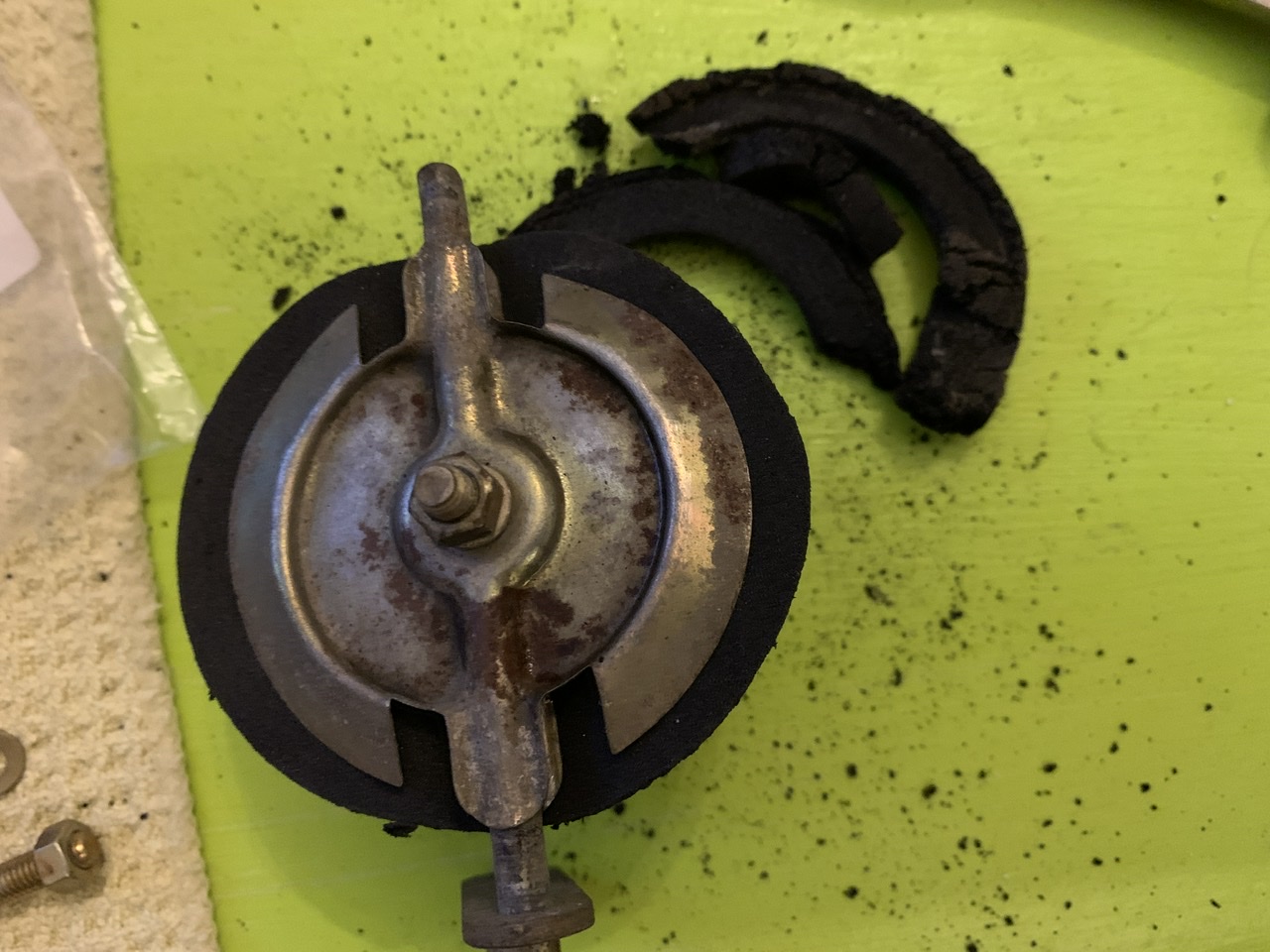

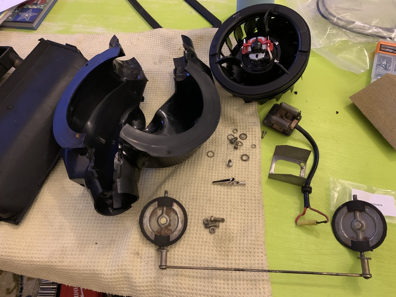

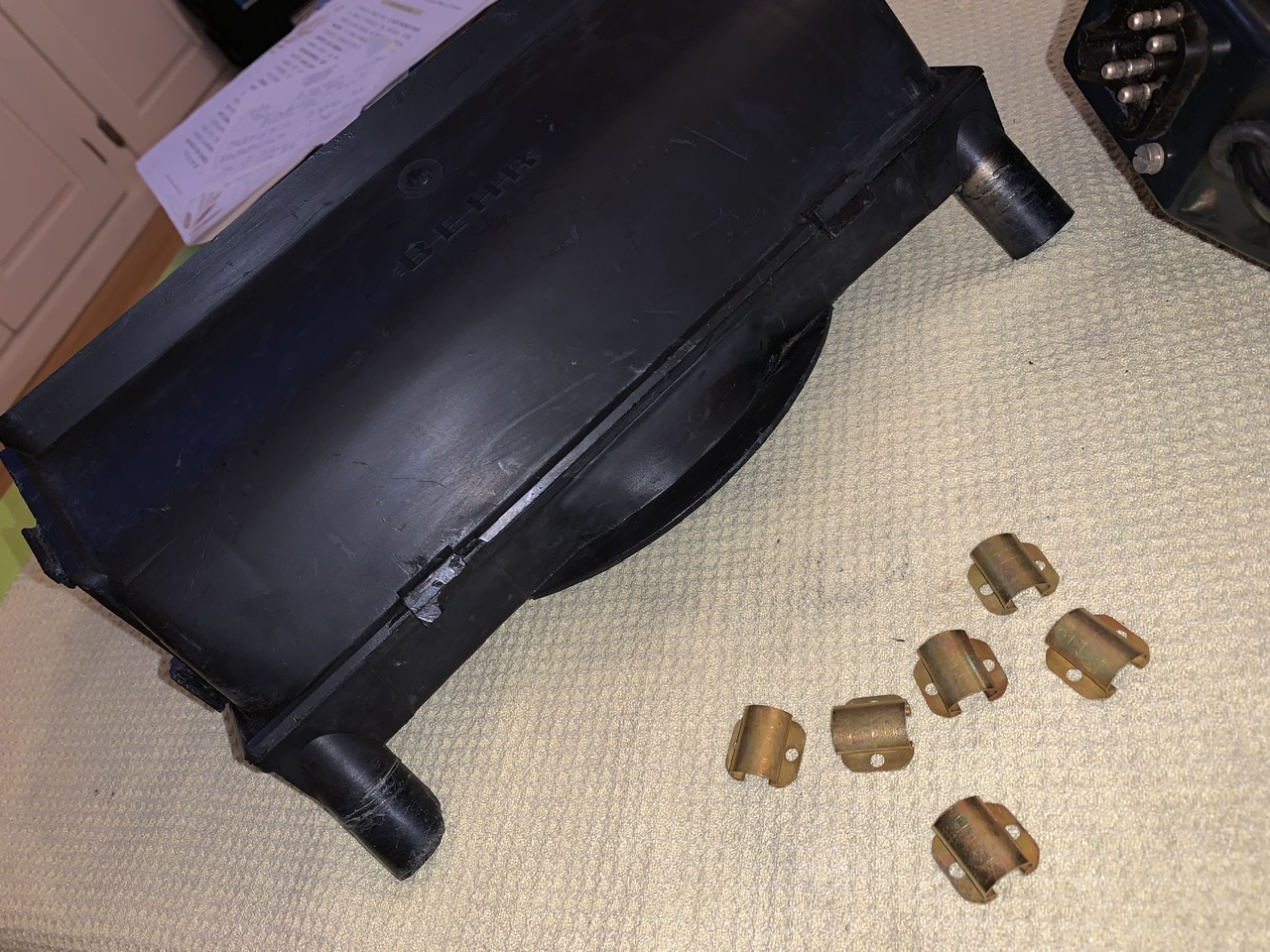

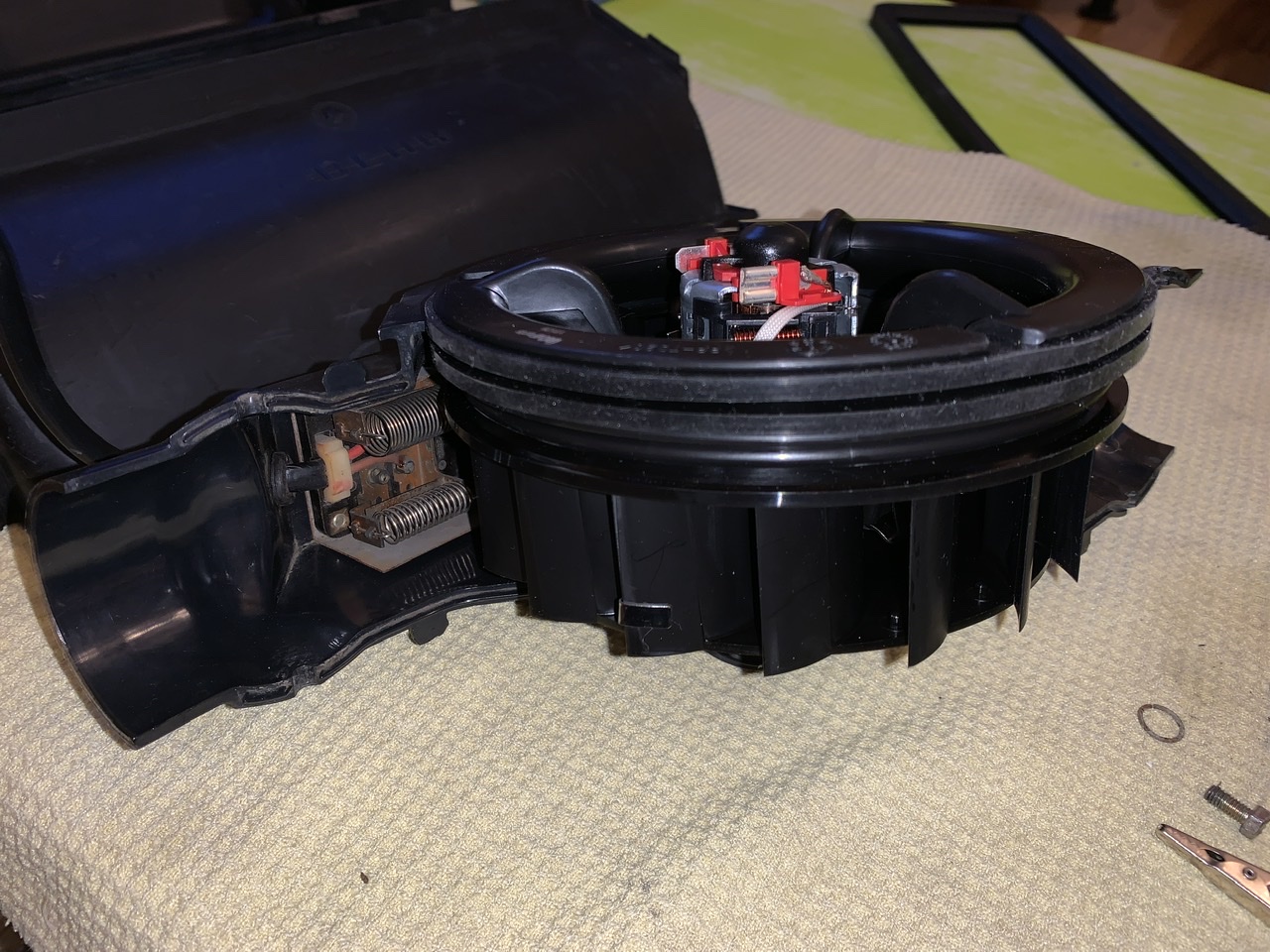

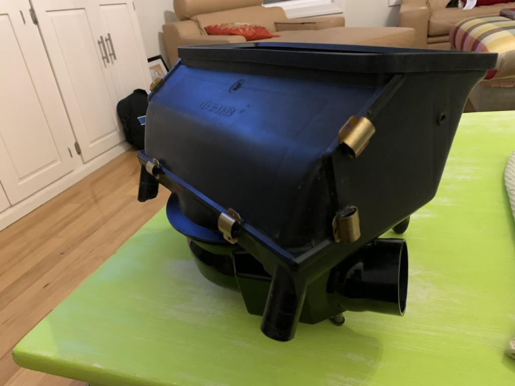

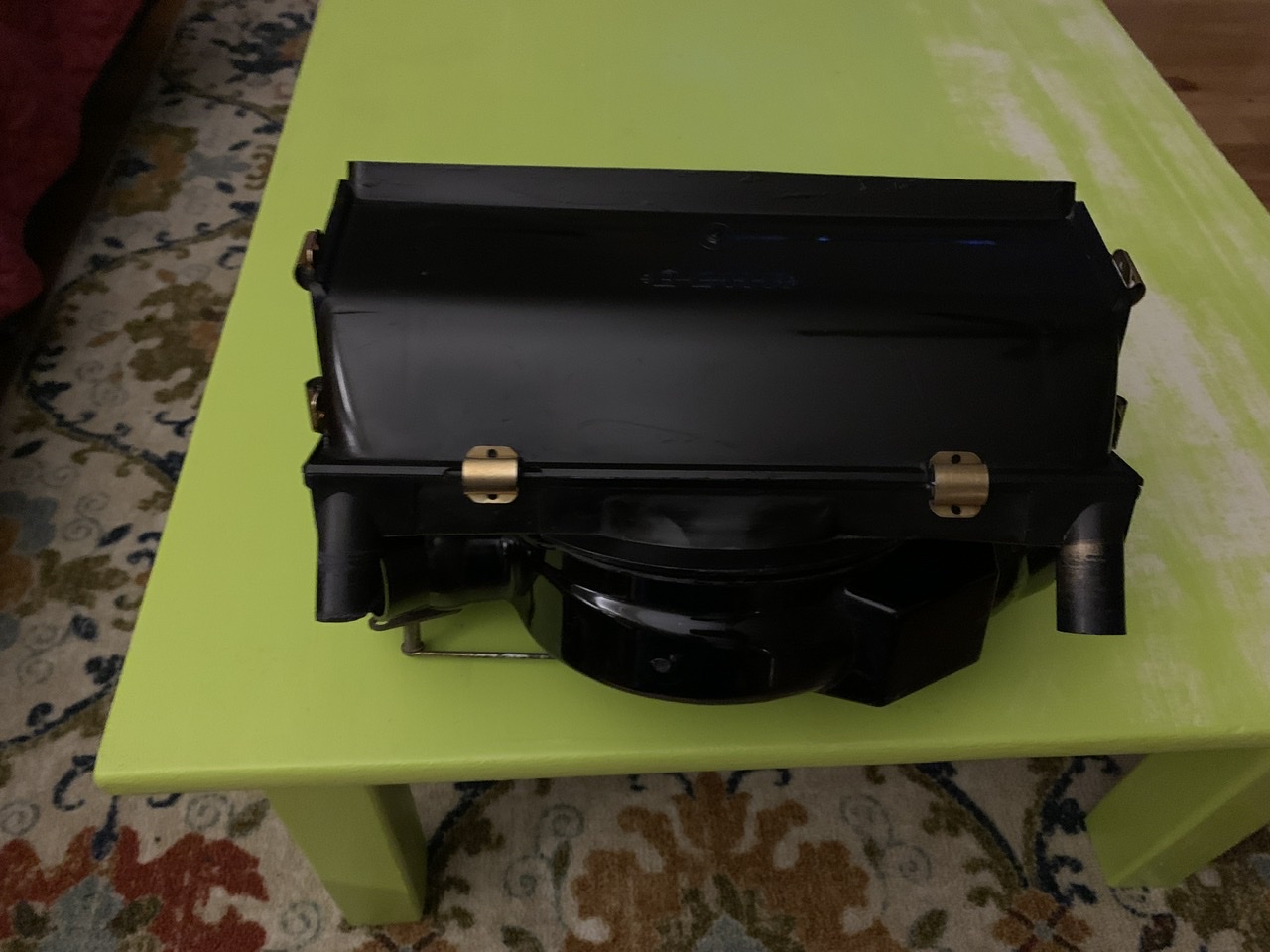

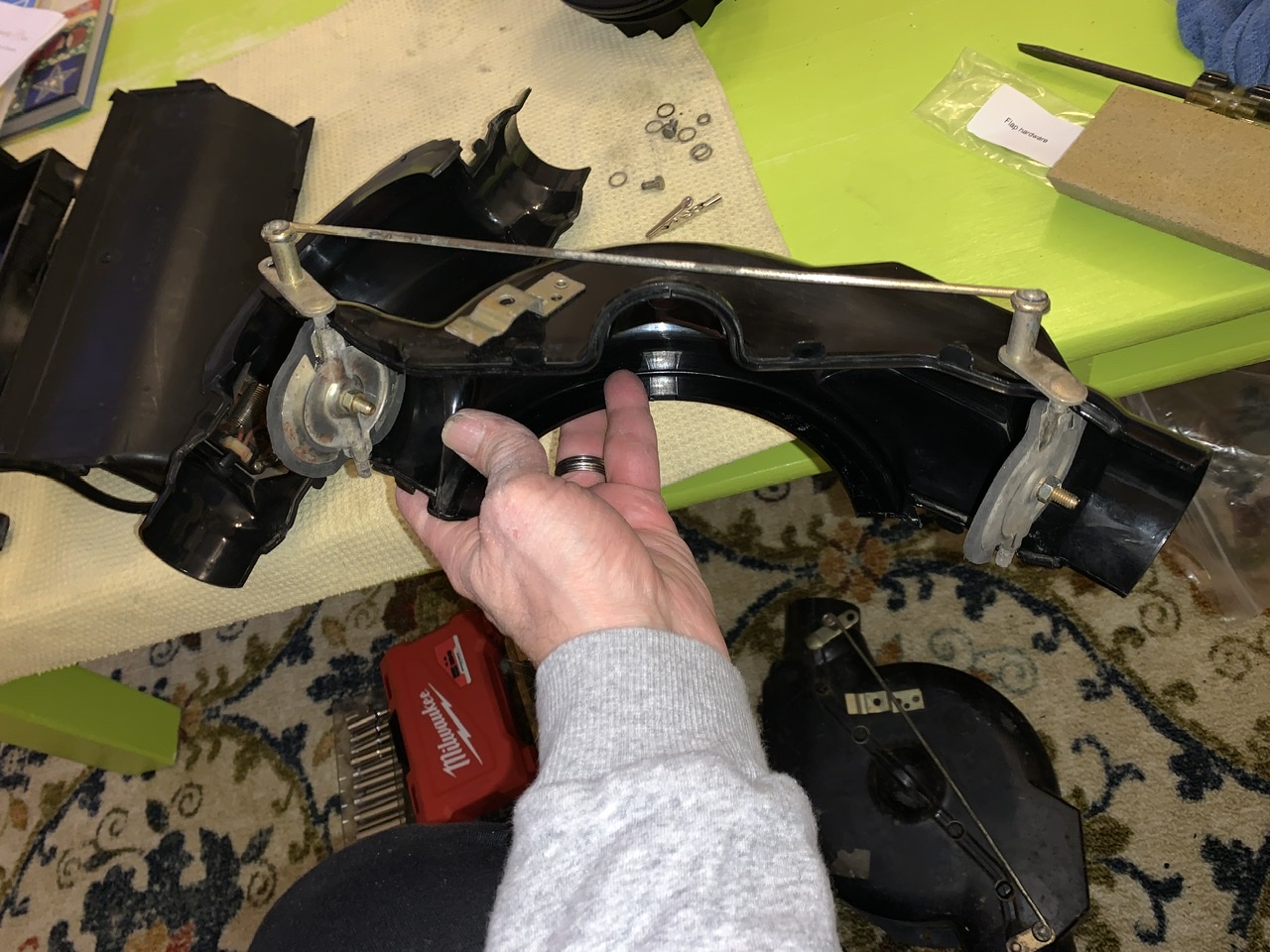

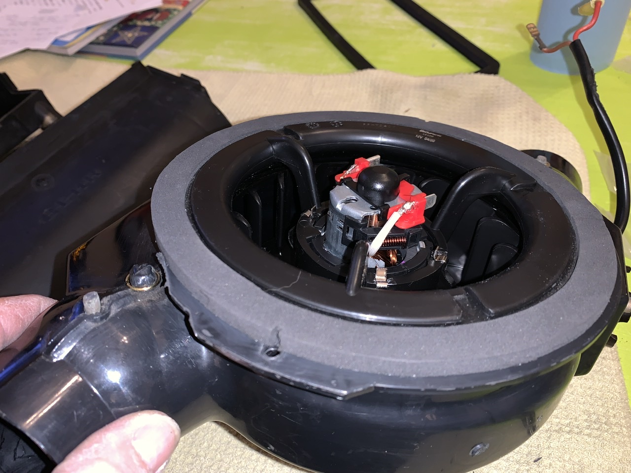

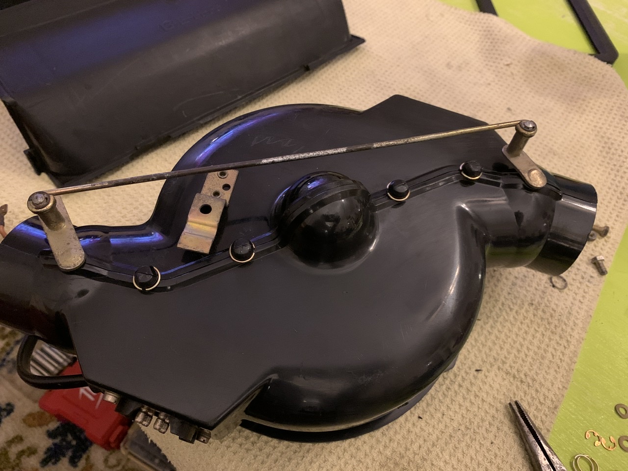

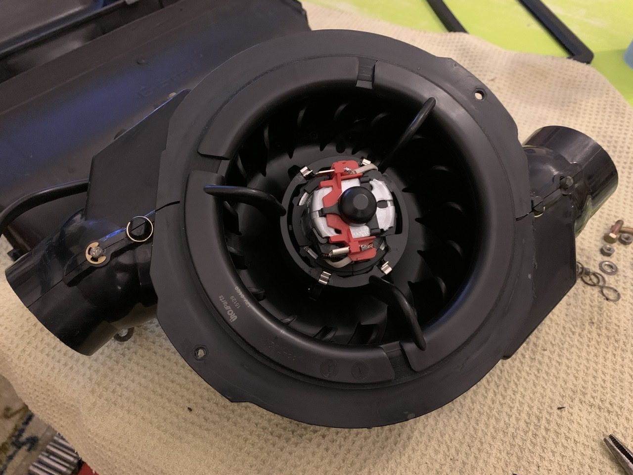

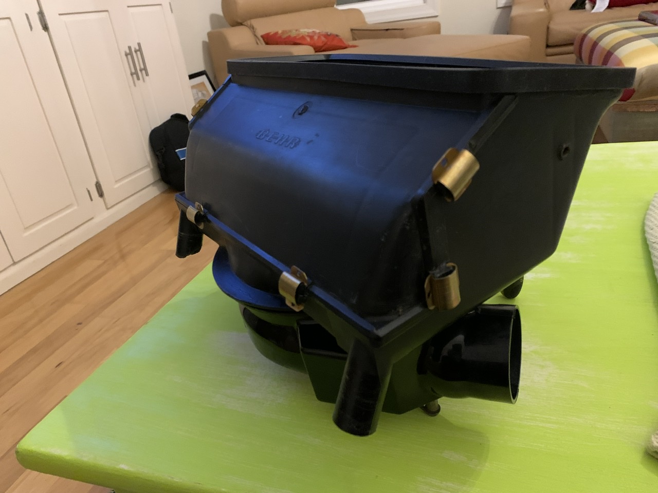

i’ve had this apart for some time and finally had the time today to really clean it up and reassemble it now that the resistor pack has been verified as working. this one got the brand new URO motor and 914rubber seal and hardware.
also i cleaned it and decreased it , used a green scotch-brite pad and then polished with 5 step just like a paint correction, went from very dull to like new.
new flapper seals, the old ones were falling apart like dust . will ah e to drive the car this week to empty tank and then i can install the new fan box.
Attached Image Attached Image Attached Image Attached Image Attached Image Attached Image Attached Image Attached Image Attached Image Attached Image Attached Image Attached Image

DRPHIL914   i’ve had this apart for some time and finally ha...   Feb 14 2021, 09:51 PM
DRPHIL914   after polishing , overkill i know but might as wel...   Feb 14 2021, 10:03 PM
