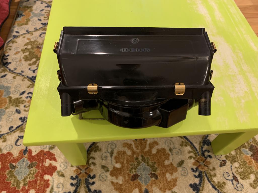

after polishing , overkill i know but might as well make it look as stood on the outside as on the inside. once i get to the point of installing it i will post again, i hAvr to change sour my controller and cables, which Mark also has and supplied with this kit.
the only thing i’ve not located that may keep some from restoring their box is new resistor assembly . in the end i found 2 boxes that had good ones. i have another box i will rebuild when i get new seals for it too, this one will go in my car , that one will be offered up for sale.

DRPHIL914   i’ve had this apart for some time and finally ha...   Feb 14 2021, 09:51 PM
DRPHIL914   after polishing , overkill i know but might as wel...   Feb 14 2021, 10:03 PM
