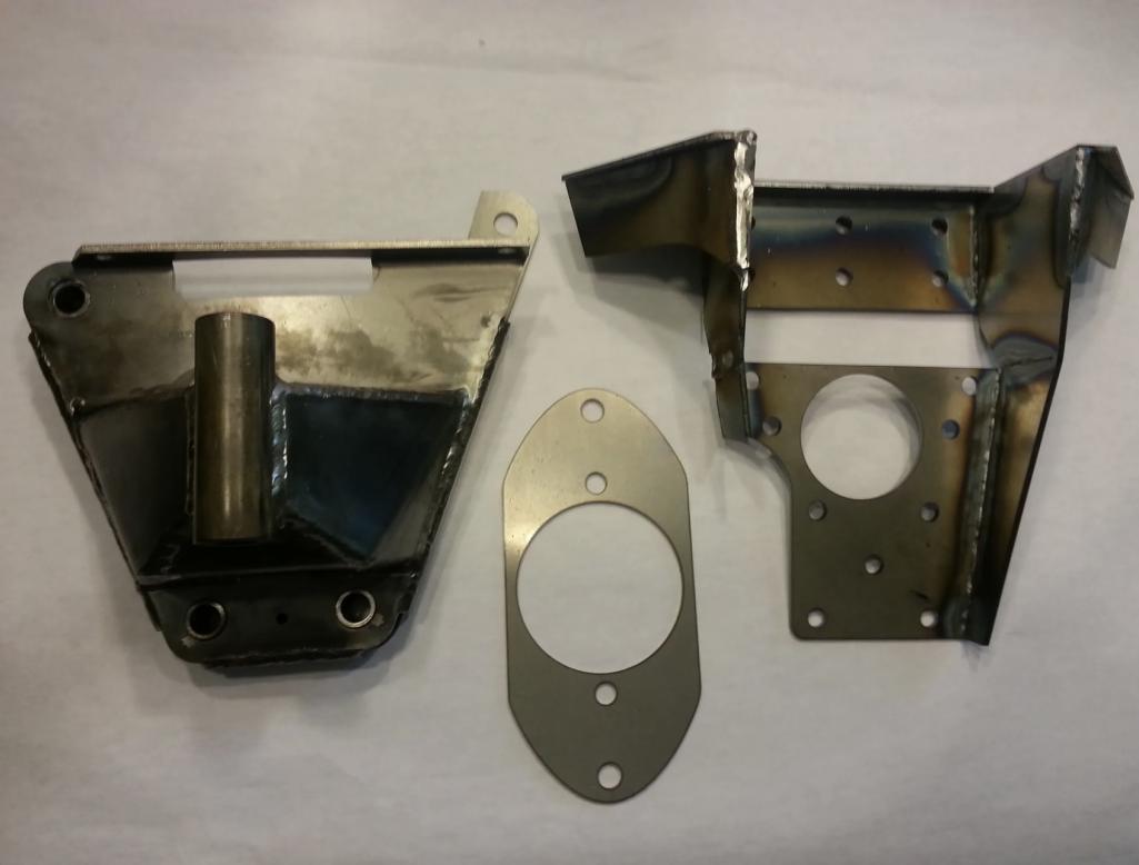

Making the conversion to a 6 cyl, we have several choices to make with mounts, exhaust, fuel, oil tank, engine tin, ....
I recently purchased the OEM mount from Mad Dog, you couldn't ask for a better fit. It nestled into the recess and allowed basically no room for error. I socked it in with a couple self tapping screws and went ahead with the plug and fillet welds.
I removed the paint from the mounting surfaces with paint stripper and cleaned it up with a sanding disc prior to welding
From what I understand the factory placed additional reinforcement in this area. Running the welds for this mount I sensed it the way my MIG was acting. I bet you could pick the entire car up from this mount. Very well done Mad Dog Attached Image Attached Image

any chance of seeing a few pics 'as received'..... before install ?
post Feb 14 2021, 11:00 PM
914-6 GT in waiting
Posts: 20,931
Joined: 19-September 09
Member No.: 10,825
QUOTE(rgalla9146 @ Feb 14 2021, 11:22 PM) *
Rory - this pic is from the website.
a visit was made.....thank you Mark
and thank you Madog for producing the most logical mount.
now that the repro rubber part is available IMHO this is the best choice
