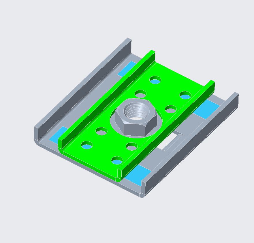

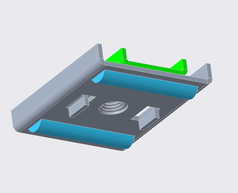

Hi Guys, with the help of Luke M, we think we will have a viable design to replicate the bottom and top plates that you are discussing....more to follow soon.

maddog   Here is what Im thinking for the bottm plate?   Feb 16 2021, 02:36 PM
Superhawk996   Here is what Im thinking for the bottm plate? ...   Feb 16 2021, 02:55 PM
maddog   Hawk, I think the thickness of the bottom plate is...   Feb 16 2021, 03:04 PM
Superhawk996   Hawk, I think the thickness of the bottom plate i...   Feb 16 2021, 04:04 PM
