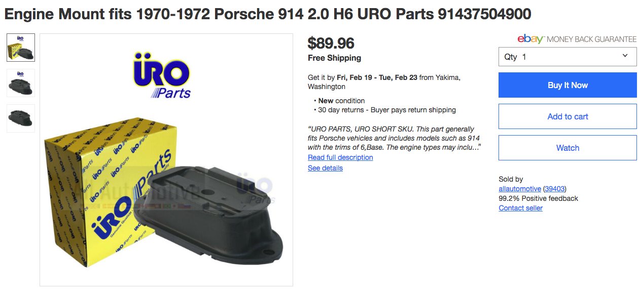

I saw this on ebay.

I saw this on ebay.
Well, that was motivation enough to get me to stop procrastinating and actually order the URO mount. (IMG:style_emoticons/default/aktion035.gif)
