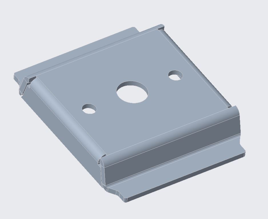

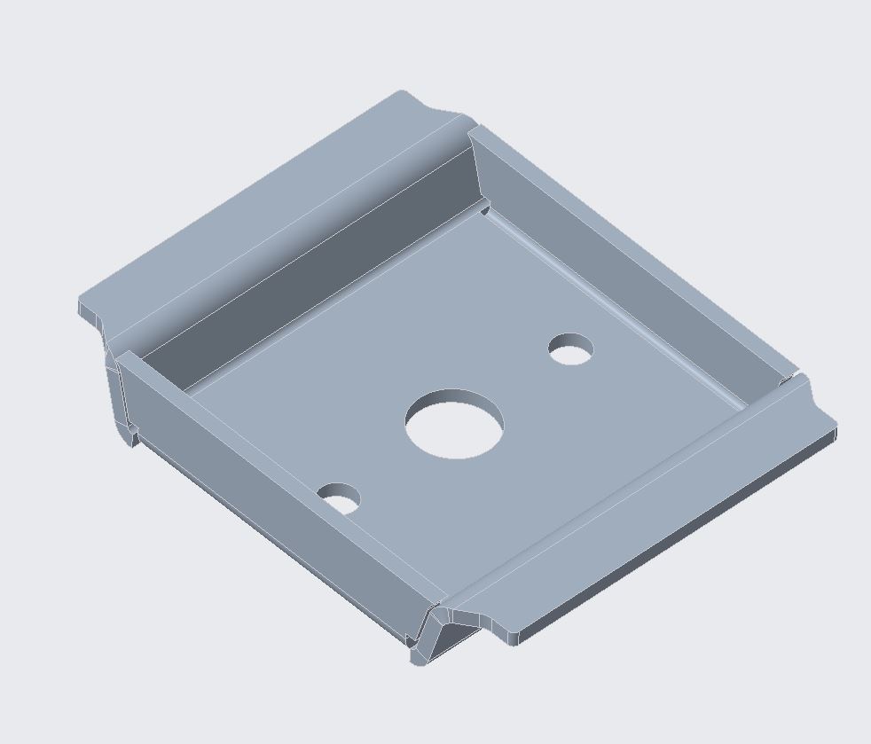

Here is what Im thinking for the bottm plate?

QUOTE(maddog @ Feb 16 2021, 03:36 PM) *
@maddog
Looks pretty good.
Assumed constraints on my part based on what I see:
laser / plasma cut
Welded at seams
Need to be thick enough gauge to avoid "blowout" when the snubbers engage.

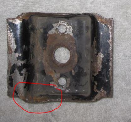

From previous picture posted I think this one is showing minor signs of heavy snubbing somwhere in it's past. Not a big deal but would be nice to proactively address it. Still totally functional as-is.
I was figuring I'd machine them as one-off but I totally get sheetmetal weldment is the way to go to keep price resonable and to match OEM look. Woundn't have any hesitation about your proposal as long as it is as thick as OEM or a tad more.

maddog
post Feb 16 2021, 03:04 PM
Posts: 201
Joined: 19-May 03
From: Grand Rapids Michigan
Member No.: 710
Hawk, I think the thickness of the bottom plate is about 2.5 mm(.098"), Im going with 12 ga steel which is about .105" thick?
Superhawk996
post Feb 16 2021, 04:04 PM
Posts: 8,134
Joined: 25-August 18
From: Woods of N. Idaho
Member No.: 22,428
QUOTE(maddog @ Feb 16 2021, 04:04 PM) *
Overall I'd say that is great and pretty comparable.
The 0.007" inch won't net much in terms of increase in stiffness or durability of the snubber. The shape has more to do with stiffness than the slight add of thickness.
Might 11 gauge (0.125") work and/or might be cheaper and easier to obtain?
The downside is don't have parts in front of me to know if that thickness add of another 0.020" causes other problems as part of the overall sytem. I don't think so. I'd rather have a stiffer snubber than one that deflects.
