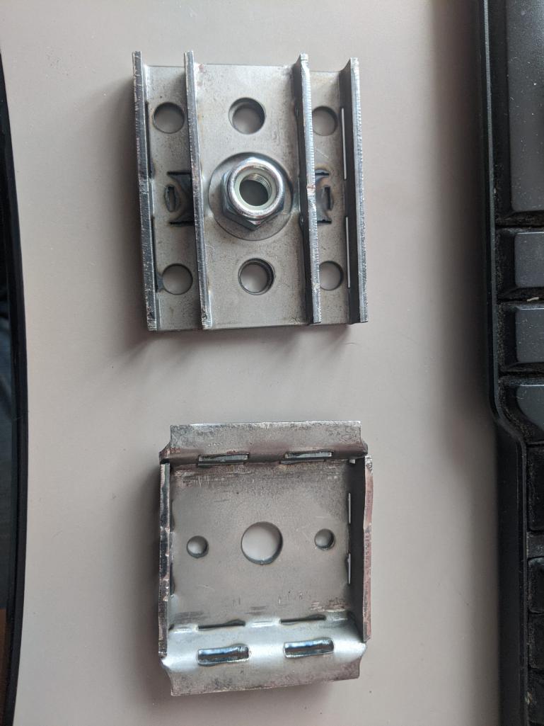

Making the conversion to a 6 cyl, we have several choices to make with mounts, exhaust, fuel, oil tank, engine tin, ....
I recently purchased the OEM mount from Mad Dog, you couldn't ask for a better fit. It nestled into the recess and allowed basically no room for error. I socked it in with a couple self tapping screws and went ahead with the plug and fillet welds.
I removed the paint from the mounting surfaces with paint stripper and cleaned it up with a sanding disc prior to welding
From what I understand the factory placed additional reinforcement in this area. Running the welds for this mount I sensed it the way my MIG was acting. I bet you could pick the entire car up from this mount. Very well done Mad Dog Attached Image Attached Image

got the blanks the other day, formed them up, just have to weld them now.

maddog   so not happy with how the first prototype turned o...   Feb 23 2021, 09:26 AM

maddog   UPDATE: got the new blanks formed and tig welded, ...   Mar 10 2021, 11:54 AM

maddog   just picked these up from the platers, turned out ...   Mar 18 2021, 04:56 PM
maddog   here is the top bracket   Mar 18 2021, 04:57 PM
